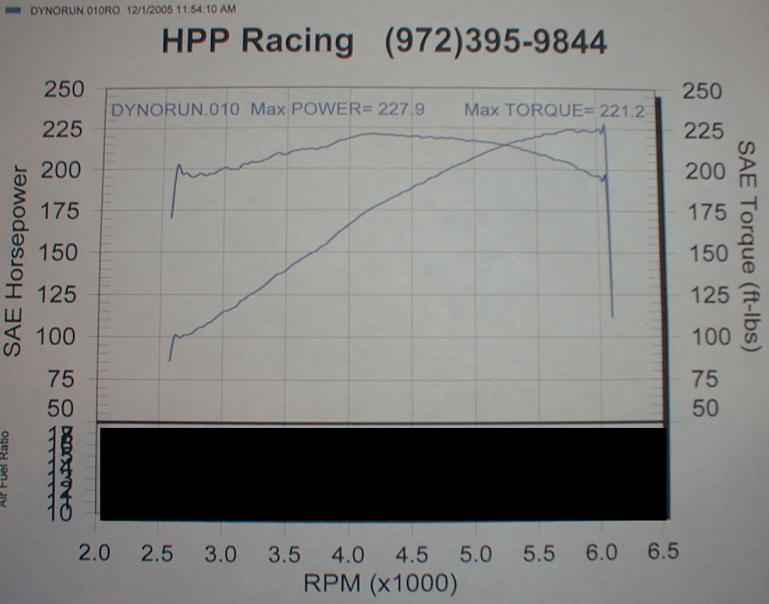

Earlier this week we bumped SuperVerde from about 5 pounds of boost to a tick over 7 psi. Here are the results
- Dyno7psiVerde.nomixJPG.JPG (231.52 KiB) Viewed 12284 times
Of course that's horsepower and torque at the wheels! I am quite pleased with these results. That's a 52% gain over stock with about 50% increase in air. That shows the efficency of the Eaton/Magnuson supercharger at these boost levels. Power is very stong right off idle and as you can see from the graph it has 200 ft/lbs of torque at the wheels by 3000 RPM. If we use the often accepted driveline loss numbers it works out to about 275 flywheel horsepower.

Micke, you are right, more RPM would be better but the stock rev limiter is 5800 RPM and I am trying to show improvements over stock so as it is I feel I am cheating a bit by going to 6000. Plus the Stage 2 injectors run out of capacity at this point so for more power, via either more RPM or more boost even bigger injectors are needed. That means Stage 3Ms and modern fuel managment. Keep in mind with the 3.55 rear end 6000 rpm is actually pretty darn fast in each gear.

Hi Zamani, I did it to create controversy and make the site exciting again! Actually I was trying to reduce the kb count so I could post it on the alfabb, I was not succesfull. The mixture looks exactly like the 205 rwhp data, we just moved the whole curve up for the extra boost. The RTEC adapter has a fairly smooth transition from round to square. Next time you see my dad take a look at it if you want. He is comming back for that drag race!
