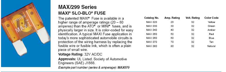

Don according to my service data the solenoid draws 38A at rated voltage.I would suspect that you're going to need at least a 50A fuse to allow for higher current values possible at lower voltages.What you want is a "Maxifuse" and holder available at autoparts stores.
- MAXI.jpg (32.55 KiB) Viewed 10403 times
