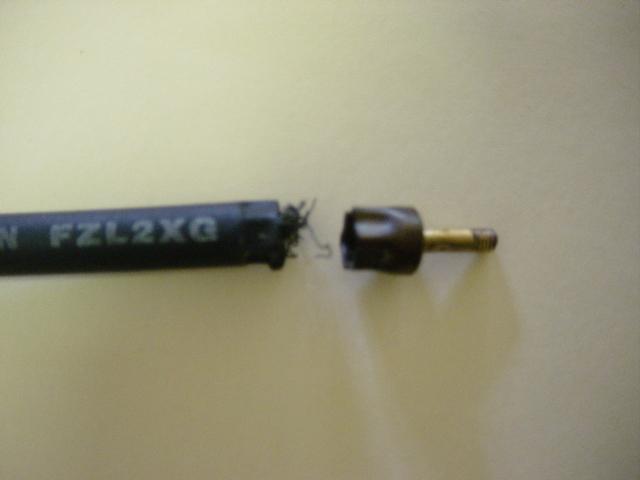

I just had a set of new ignition leads for my GTV6 made up by Queensland Ignitions in Brisbane. I re-used the original Bosch resistor tubes and the plug/cam cover seals. The new leads include 1K resistance distributor cap ends and are 7mm stainless wire centres and the 3mm brass end to screw into the original tubes, see pic 1.

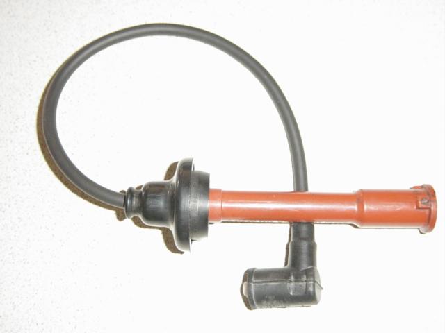

Another option is to use the resistance 7.0mm silicone spiral core cable and replace the Bosch tubes with non-resistance straight through tubes and new 90 degree plug/camcover seals. Doug at Qld Ignitions made up a sample of this lead, see pic 2.
Pic 3 shows what I found in one of the tubes of the original set. Seems the end was twisted off some time ago and the wire was just stripped back and pushed back inside the tube. Also nice and corroded.
