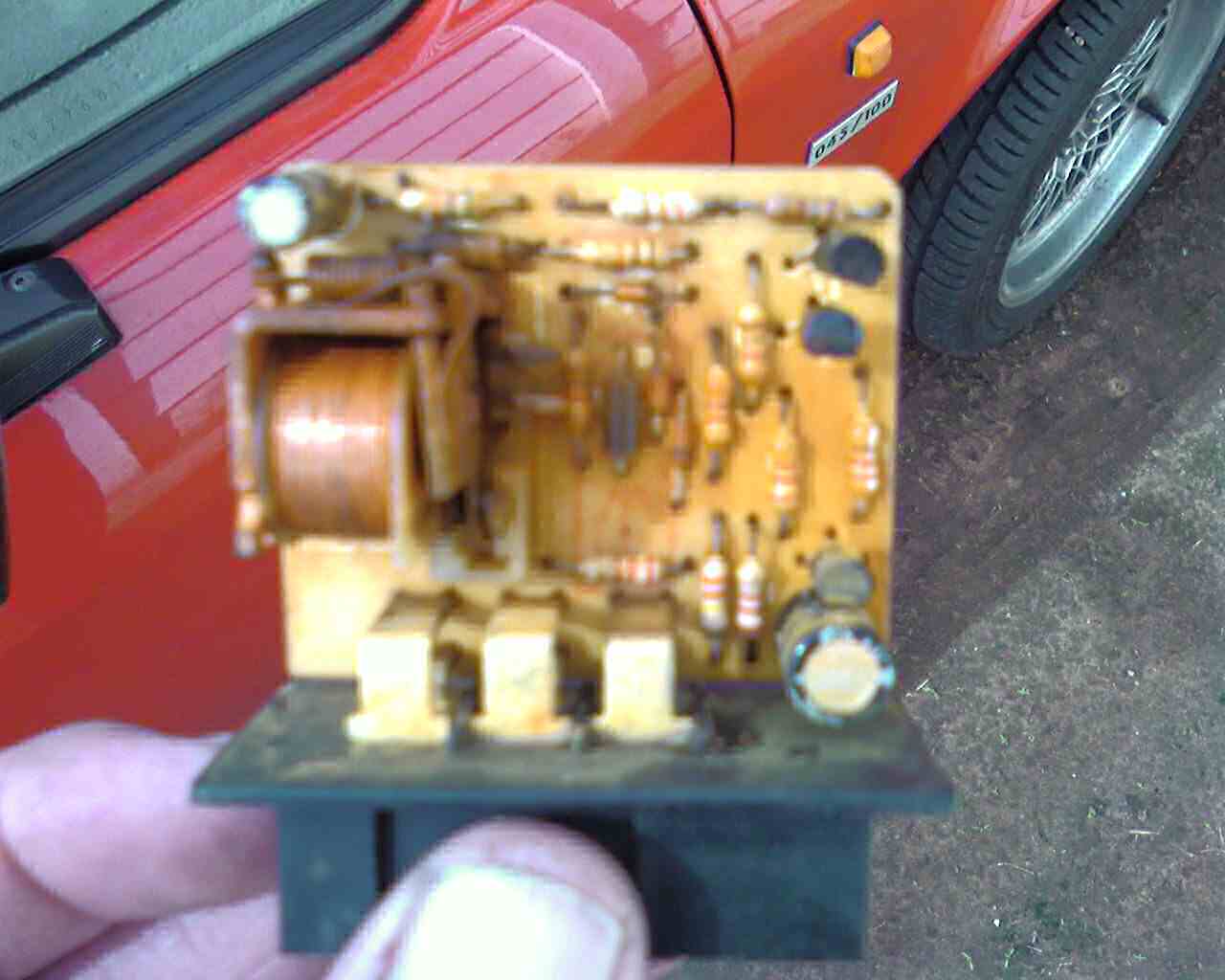

I found this one in a box of GTV6 parts.Can anybody tell me what its function is ? I'm sure it will add at least 15hp.if I plug it in :D

hmm think i have one of those in my 2 litre gtv...well the plug looks similar...think its for windscreen wipers

Yep!
I think it is from the wipers too...
Good to have it! (if it works!).
15hp more will definitely cure those SLOW wipers ;)

Apologies for the delay in replying. I found your query while browsing though the forum. Yes, that is the windscreen wiper relay and your query reminded me of the time I was driving my '86 GTV6 in heavy rain on the highway. Of course I had the wipers going full blast. When the rain stopped I found that I could not turn off the wipers. The lower left corner of the windscreen on the GTV is a great place for water leaks into the car ( just above the fuse box assembly !)and subsequent investigation revealed that the leaking water had corroded the terminals so that the relay was energized all the time. The wires to the relay are just long enough to allow you to move out the relay and mount it "upside down" with the terminals pointing down.
Now I have wipers when I need them.

My wipers have been doing the same thing.Just wont stop wiping, had to pull the fuse to get them to stop.
Ill have a look at that relay..

Finaly got round to that relay over the weekend, was still full of water when i took it out.The whole thing was brown on the inside.Let it dry in the sun for a bit, cleaned with a toothbrush, and sprayed some anti rust on it.Did notice that the cap on the bottom, by the relay did not look so good.
Put it all back together, works like a charm :lol:
Did also notice, while the relay was full of water, that my indicators would go "slow" when i hit the brakes, and when driving with my lights on..Seems to be gone now..

Just a pic of that relay, before i cleaned it.. :shock:

Managed to locate the relay and mine too was full of brown water. Let it dry for a bit, popped it back in and now all fine.
Read somewhere that you can mount it upside down so that the connecters are pointing down but ive found that you wont be able to close the fusebox if you do this.
