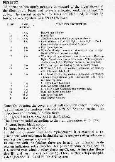

could some body give me a run down of all the fuses amperage in the fuse box from left to right? my 1984 gtv6 owners manual is escaped.

Here you go.This is from an 83 but likely the same.

thank you so much!
