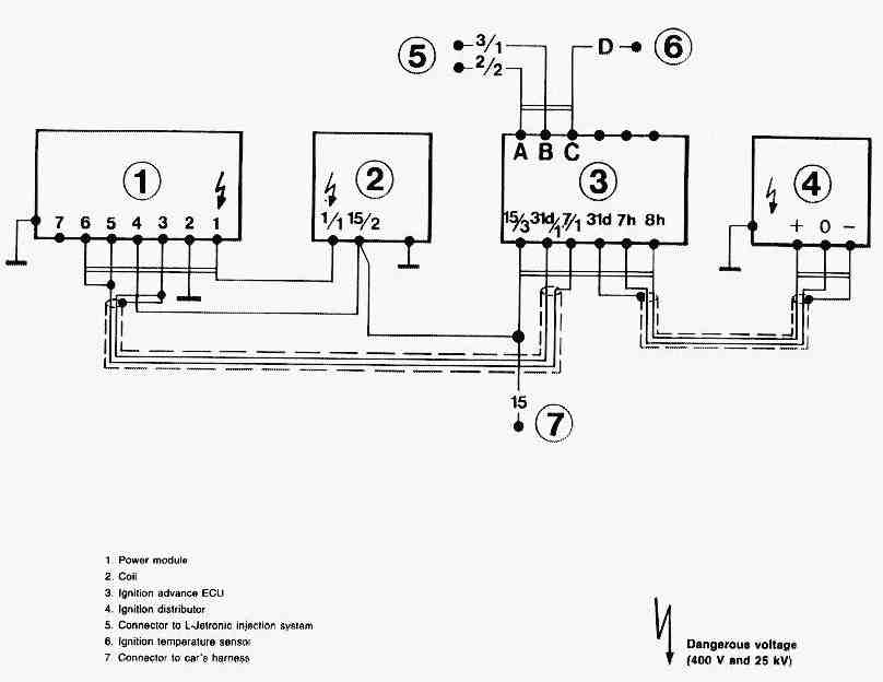

Ok thanks. Now which of the components in the image below is it and what does it do ? I have an aftermarket (Jacobs) coil and the Alfa schematic is weird in the way it shows the wires running between the various components.
#4 is the distributor with its Hall effect signal, #3 is the advance module with the stored advance map, #2 is the coil. and #1 is the actual "electronic ignition" power module which handles the high primary coil current. These power modules are practically indestructible and have been used in umpteen million cars, a Bosch success story. In AR, they were first used in Alfasuds, when points disappeared and from then on in almost every model made, except Motronic equipped cars. The module is so good, it has been copied by other car-part companies in large numbers and in the exact same package.
