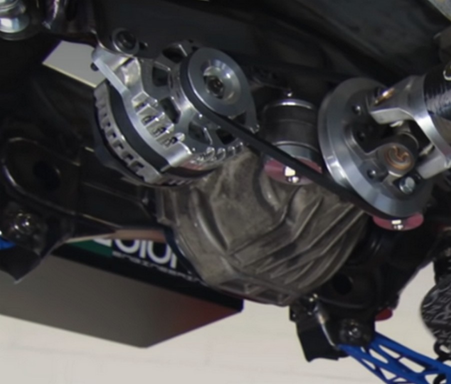

Well the idea has certainly been deployed in very many forms before. Fortunately for the transaxle, the differential isn't moving with the suspension like a live axle which would give the alternator a hard time most likely on the fatigue fracture of the electrical connection.
If the alternator was mounted to the cross member it should work fine as it would be in a static position. Much like the one on the Supra conversion in the photo.
Cooler running, better weight distribution but the offset is much more contamination from road wash and grime particularly from salt on the roads would kill it off pronto. There is also a nuisance factor that requires the disconnection of the propshaft to replace the pulley belt.
- Supra alternator to propshaft.jpg (83.03 KiB) Viewed 6171 times
