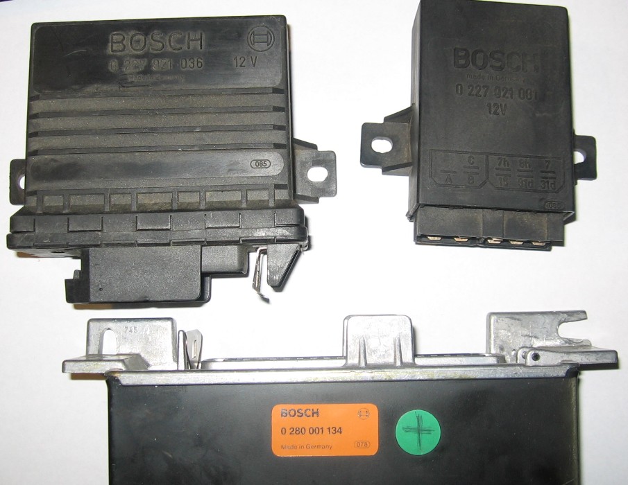

OK: you have to answer this question:.. Which wiring harness do you have and is it in gtv6?
IF you have a 3.0 engine..you want to use the 3.0 ECU and the GTV6 spark control on a gtv6 harness.
3.0 ECU is specific to the 3.0engine in terms of fuel delivery...especially if you have a 3.0 with more air at higher rpms...you will run lean even with TPS at full.
3.0 or 2.5 Milano spark box is totally different than 2.5 GTV6 spark box, so that you can't just plug new box into old GTV6 harness and v/v.
Also, you will want to make the resistor change in the 3.0ECU as previously discussed
I am not sure if rev limiters are "country of Destination" specific...meaning Bosch may have built Country specific components
Top Left: Milano Ign Control<br />Top Right: GTV6 ign control<br />Bottom Cenber: 3.0 ECU

The wiring is from a 3.0 75/Milano
I have the same looking boxes (different number though) as the one in top left and bottom so a 2.5 ign. box won't fit my wiring I see... :(
But thanx for all your help :)
