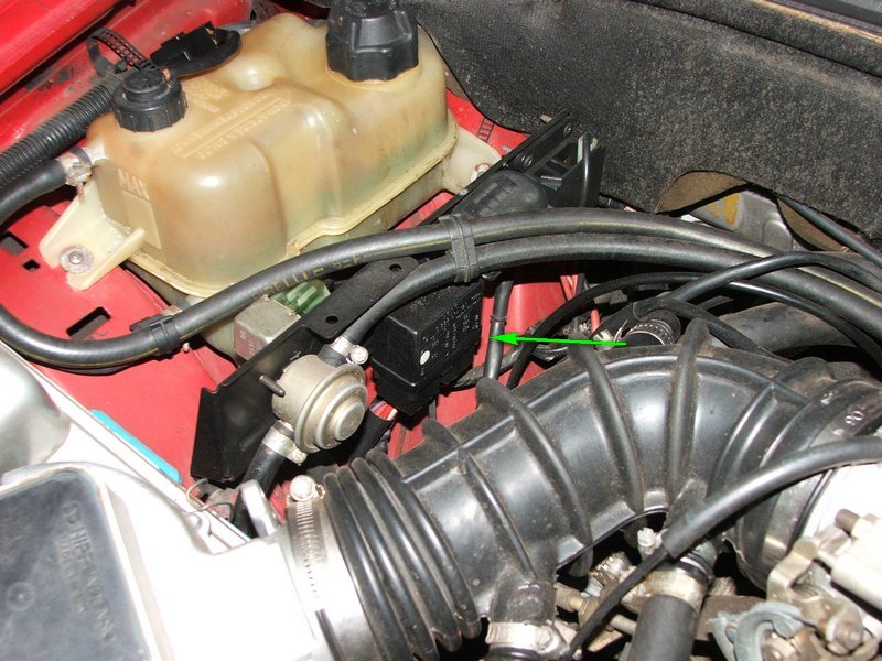

Re: Milano Verde Has No Spark
Merril
If your car has one of these, fit a new one.
- Multipin dual relay 1.jpg (135.31 KiB) Viewed 4286 times

The first thing Group 2 did was swap out the dual looking relay on the firewall. No luck. I'll ask them about the one you've shown MD.
