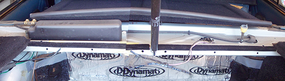

Got a sheet of Dynamat in since the tank is out, and I've bean meaning to pull the Koni shocks and turn them to the softest setting... easy thing to do with the tank out! Thought I'd throw in a picture of the evap. system up above the tank - the lines are all hard as a rock, and I'll replace them all once Greg G's kit arrives. GV

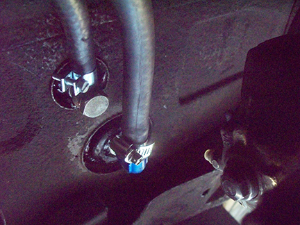

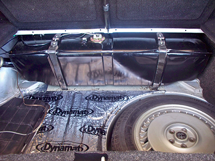

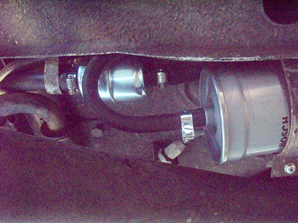

:D Full tank of gas and ready to use it up! Best off all... NO leaks! Putting up a few last photos, tucked the low pressure fuel filter for the main line to the pump just back of the standard Bosch filter, it fit real nice :)
The 90-degree Earls fitting that threaded into the tank lined up just right. I had the shop weld the bung so that the when the Earls fitting was screwed in just hand tight it point towards the front of the tank - once in place I was able to wrench it around for two full revolutions... nice and tight :)
