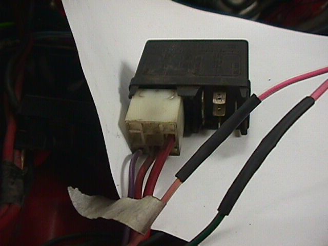

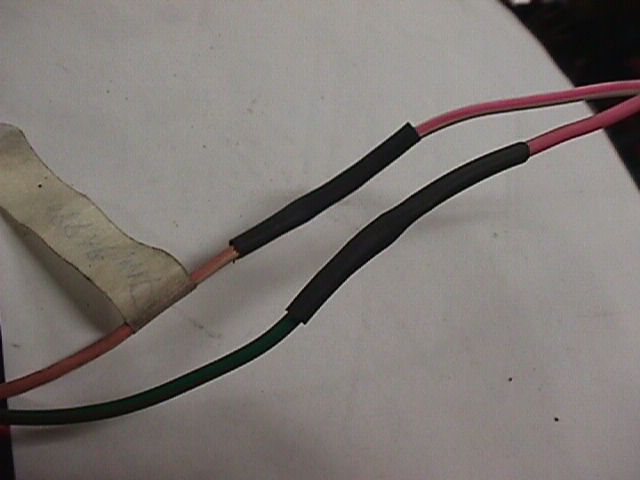

Now I´ve started to connect the wires. Did as you said (and I suspected). Pink/white from the M-loom to dito from the car (fuelpump) and pink from the loom to the green/grey.
The wires comming from the car did previously go to the "double relay" (picture below) Is that how it was for you Dennis? Is that relay needed at all now?

The green/black you connected to the same green/gray as the pink I connected to another green/black that previously supplied the ignition module with +12 ignition. Since the ign. module is no longer in use I thougt it ok. This way I don´t risk getting too much current through the green/gray.

Yes I've used the GTV6 plenum because I had a set of 75 motronic injectors (and rails). I've used a regular oil pressure sender, so yes, it works with the meter.
You don't need the relay set from the old jetronic if that's what you mean. The Motronic has it's own relays (already wired in), I've mounted them next to the coil.

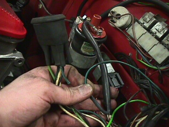

Yes, there´s wgere I´m planning om putting them too. You can see one of them next to my hand in the picture above.
Do you remember if any of the other wires to the old ignition module is needed anywhere? (It´s the black rubber connector I´m holding in the picture.) I don´t think so, but I´m not sure. There is a lot of wires left over everywhere.

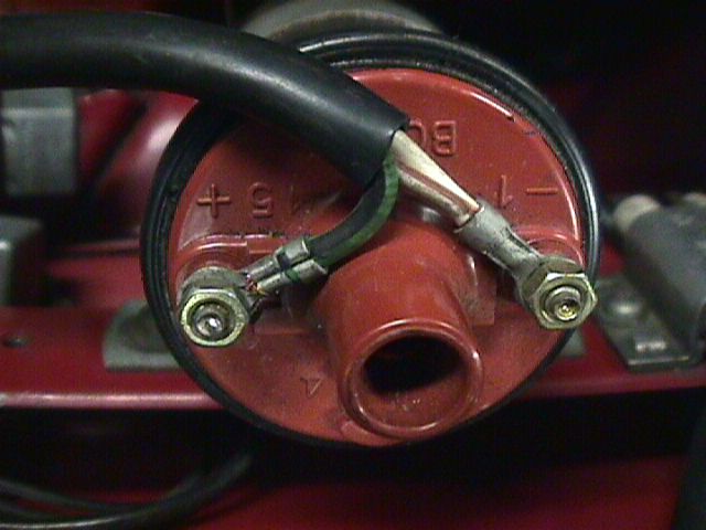

You're missing the white wire to the - of the coil. This sends the signal to the rev-meter. Might be nice to see how much you're tormenting the beast
Your connection of the GR/BL to the other GR/BL sounds good. Is it connected to the ignition switch? Sounds like a hell of a lot better idea then mine! I guess I'll have to start looking for that wire...
I think I didn't use one wire from the old ignition module. Taped it up and tucked it away.

Dennis!
I have i white wire to the - of the coil. (See picture above) It comes from the motronic. Or do you meen that the old RPM-wire is to go back to the coil? If so, no probs, it´s still hanging around there. You have the white from the original 164 on the - on the coil too right?
I thought maybe the white from the Motronic loom, (original from the 164) did the job.
