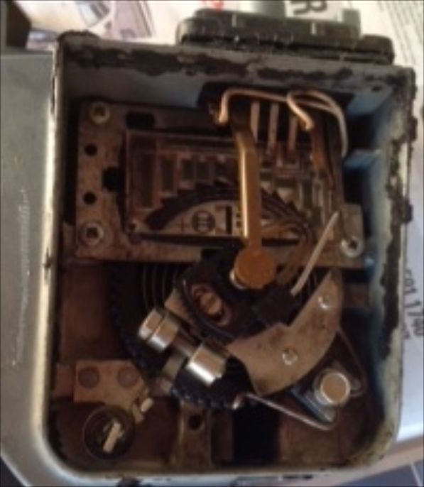

:D :D :D Update, stripped dizzy down, cleaned and checked, no play on shaft or cracks or any thing that looked suspect.

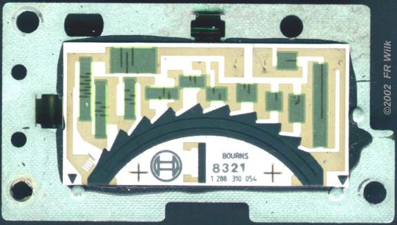

Decided to check AFM, open up and inspected under a magnifying glass, found excessive where at the beginning of the rangeon the wiper track on the PC board. :oops:
Aquired an old AFM, which I tried, but found the car almost undriveble as the spring was weak and the door kept sticking, but hesitation on constant throttle was gone.
Found another PC board and rebuild my original AFM, now motor is pulling hard with no hesitation and even response is great.
As we always say the problem is always small and easy to fix, it's just finding the problem that is difficult.
See wear marks on the start of travel on the wiper track on the PC board.
Pic of what a wiper PC board should look like.
Worn PC board on AFM.

Quick report back before off to Mozambique for few days, problem was definitely AFM. The car is now perfect with no stutters or hesitation. :D
