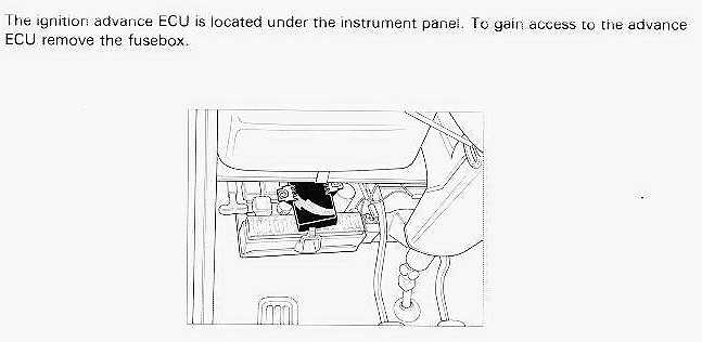

Tell me where it is and what it looks like ,and I sure I have 4 of those too.
Drive'm Hard
Murray
Posts: 622
Post by Murray »
No problem (for me :evil: ) The infamous EZ-L is in the dashboard on the drivers side.Lie on your back and look up above the fuse panel.It's a black plastic case the size of a cigarette pack and is fastened to the firewall with 2 x 10mm nuts.It has two wire connectors hooked to it.Don't mistake it for the wiper relay which is sort of similar but is normally attached with a screw to the lower dashboard edge.Also ignore Alfa's suggestion that you remove the fusebox - make work project for Alfa mechanics :shock:
