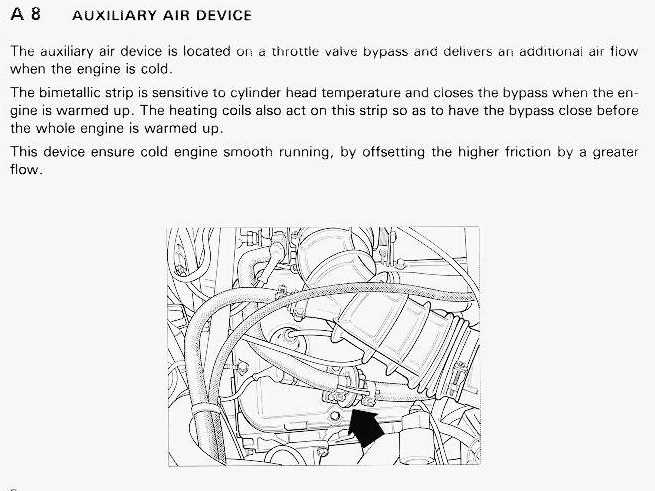

That was my thought: air leaks--could be anywhere or anything. We did notice a collapsing hose on the right side (passenger side on a LHD) at the rear of the motor. Hose comes from the bottom back of the plenum to a valve or regulator mounted on the valve cover. A little pancake affair with inlet and outlet type orifices. The front one has a hose that Ts into the big accordian hose from the air flow meter, and into the side of the plenum.
Don't know what this valve/regulator is called or what it does, but Spiders have them, too. Apparently a standard L-Jet fixture. When I get some time next weekend I'll replace that hose and, perhaps, try another of those valve/regulator fixtures from my Milano.
What is that device? And what and where is the idle valve?
Thanks again for the suggestion.

Mel the device you're describing is the AAV (auxiliary air valve.) It is bolted to the valve cover and provides an extra shot of air during cold startup.It is important that the hoses going to and from be in good order so that may resolve your problem.As far as smelling gas, that`s likely a seperate issue and should be dealt with NOW unless you don`t really love your car
- AAV1.jpg (42.55 KiB) Viewed 18490 times
Murray:
Many thanks. This looks highly probable. I'll try another vacuum hose, then the AAV from my old Milano.
