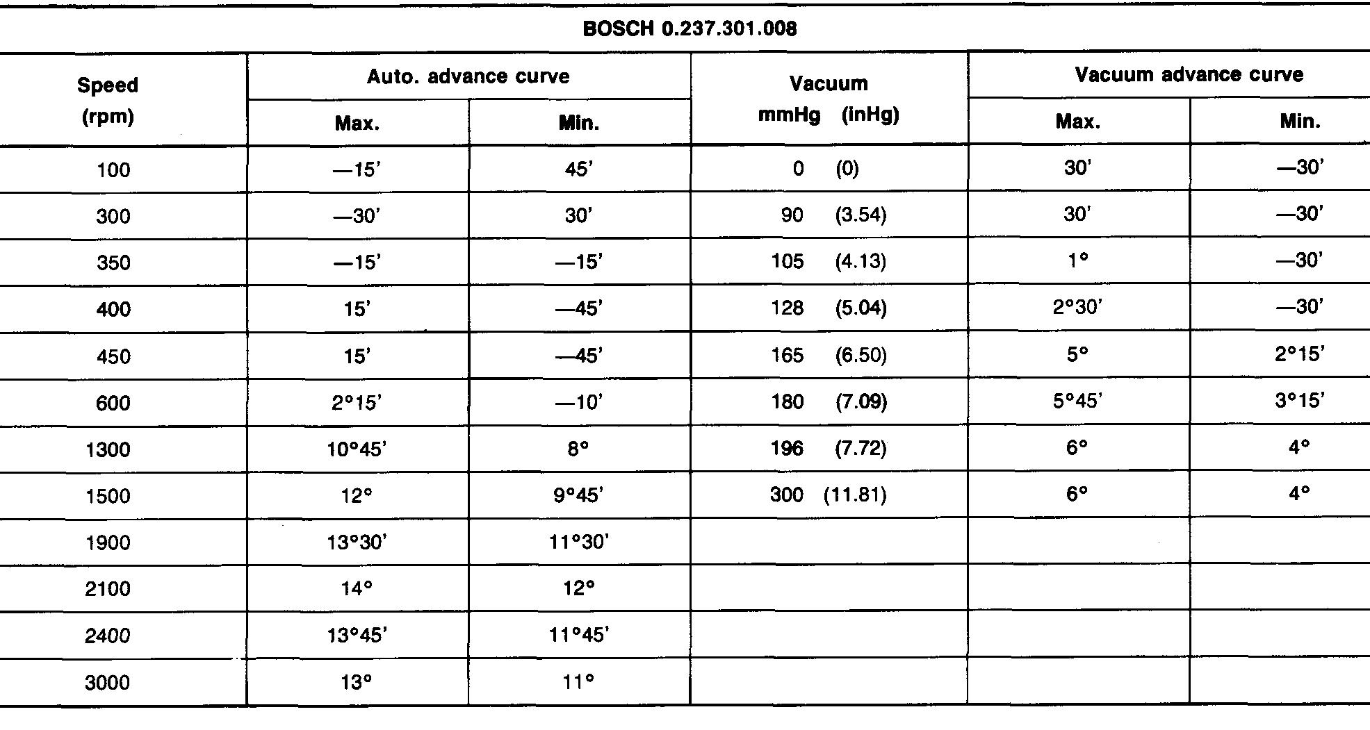

Post by enzo »
here is the vacuum advance table of the disributor of the GTV6
