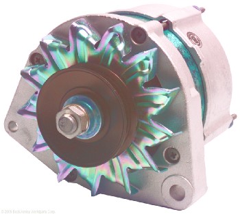

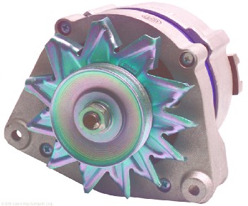

Compare the 2 alternators
Alfa 75 Alternator 75 Ampere
BMW E30 325i 1989 90 Ampere
Zamani: Mounting holes are a little smaller on BMW as I found out. Your pics look so much better than the real thing!
