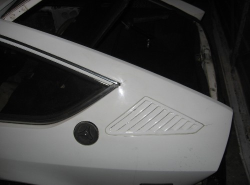

I have another question for you; I picked up some louvered and G T V stamped early Alfetta rear extractors to replace the plastic schlock. They definitely do not fit the openings on the '85 GTV6. Did yours? If so what year is your car?

As for the rear vents/louvers....no, you need to drill 2 or 3 holes for the cast in place screws mounted on the louvers. They do fit the opening, but are not 100.00% flush....

The rear quarters on the 85 I have has different pressings. The plastic louvers fit in the pressing without overlapping. The older louvers have HUGE gaps (up to 1" or more in places). They would not fit anything like on yours. Shame. Something else to relist on eBay!

X, you have an 85? I have two, the one I removed the louver off was the earlier one. It has the older style gearchange the other car (that needs the battery cable) is has the isostatic gearchange and the different torsion bar location.
I haven't looked at the more recent one to see if that has the same body stamping. I suspect it is.
They were both manufactured in late 84.
Strange. What is the VIN on yours?
