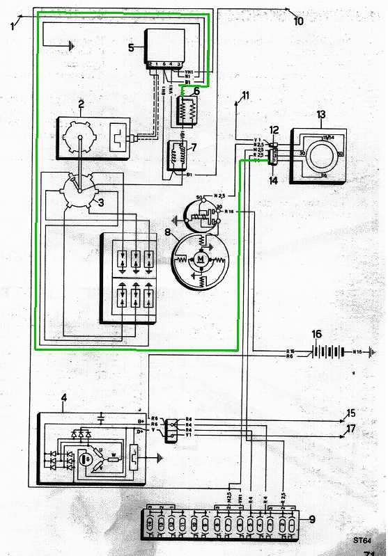

jtferris what I would suggest you do is remove the bottom plastic cover on the steering column (the screws holding this together are hex-head) and follow the wires from the ignition switch to the 3 pole connector further down the column.Closely inspect the connections in this connector.I have seen them overheat and oxidize.If you look at the attached wiring schematic you'll see the green wire that I've highlighted runs from the ignition switch to a coil ballast resistor.From the ballast to the coil the wire is green/black.I have no idea what year GTV6 this diagram is from but on my 86 GTV6,Alfa no longer used an external ballast resistor but instead the wire which is green/black on my car goes directly to the coil + and should show 12+ with the ignition on.
13 = ignition switch
14 = connector
6 = ballast resistor
7 = coil
5 = ignition module (attached to the coil chassis)

aha, I traced the green/black wire from the fuse box and found it was disconnected from the coil and hidden from site. I thought the other green/back wire was the only one. Fired up and needs only some tune up and fuel line repacement.
