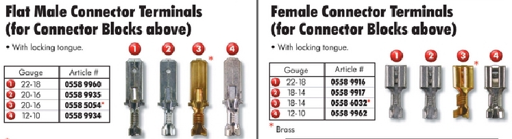

For crimps, probably the best ones are the exposed terminals and at the crimp end there are 2 "flaps". Using a good crimper, you crmp on the 2 "flaps". Then use a shrink wrap to insulate it.
JimK,
Do you mean this type of crimp terminals?
As for slow power windows, on newer cars, well at least on my '96 155 V6, the power window motors are connected to relays. Of course for the 75 you have high gauge wires (thin) getting the power from the fusebox (longer routing).
JimK,

Right-on, Zamani! These are the connectors and the required tool costs no more than $20-30. Heat-shrink tubing is a good finishing touch but not really necessary.
Mats, who said MIL gas-tight stuff?? Most MIL connectors use sockets crimped with the special 'Daniels' tools with 4point adjustable inserts, to cater for wire AWG and are not gas tight. Thats from tanks to subs, F-16's and AAM's (we do it all the time, there's a whole section at work for wiring harnesses) As for the light switch (stack) taking the load, thats why relays should be used, the point in my post.
