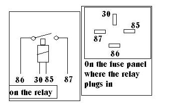

One of the local auto parts store had a relay with same plug pattern, but it was identified as being for the flashers. Another one couldn't cross reference the unit I remove (its factory original). So I guess the question is, do I just match the plug pattern when selecting the replacement?
Also is there a way to check the relay using a multimeter?
Yes there is, it's fairly easy. You will need a multimeter, wires with alligator clips on either end and a car battery. If you look on the diagram you will see a printed circuit off of a relay. This circuit should also be on your relay. The numbers may be different, but that is okay as long as you can match them up with the numbers in the car where the relay plugs into. It doesn't matter if you hook the relay up wrong, it wont hurt the relay, just try again. Okay, I don't remember the numbers exactly but we will use these 30, 85, 86, 87 The diagram is showing you how the relay works, the middle circuit is an electromagnetic switch. (30,85) when hooked up to 12v DC it switches on the second circuit(86,87) So hook the positive of the battery to 30 and the negative to 85(they should be perpendicular to each other, the positive battery hookup is the one facing the other way, I'm not sure which side is negative either 85, or 87 if it doesn't work one way, try the other) Then turn the multimeter to the Ohm or resistance setting and place the probes on the remaining prongs(86,87) or (86,85) the reading should be 0 or very close, if the reading is 1 both times, then the relay is bad. you should actually hear it click once you give it power, its pretty loud for such a small box. Hope this helps, let me know.

Rather than mess around with a multimeter trying to determine which lead goes where, I removed the cover from the relay. Here is what I found:
85 and 86 are at opposite ends of the coil.
30 goes to the body which holds the coil. I assume the coil is isolated from the body. One end of the arm has a spring loaded movable "flap" which is not quite in contact with the end of the coil. A small contact arm is mounted to the end flap.
87 (There are two 87s) are connected to a post which terminates near the end of the contact arm.
When the coil is energized, via 85 and 86 and it draws down the arm so there is continuity between 30 and 87.
If anyone is interested, I'll try and post a photo of the relay.
I'm wondering if there is someway to check the corresponding sockets on the relay mount to determine of the problem is elsewhere? Shouldn't I be able to measure a voltage between 85 and 86?

just jumper "30" and "87" (per your description)with a short 10 amp fused wire...lights should come on. Then you know the lights work

As it turned out the relay has nothing to do with the brake lights. I had miss read the poor copy of the manual I had printed out from the Car Disc CD. The relay was for the brake fluid level.
