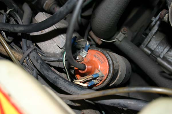

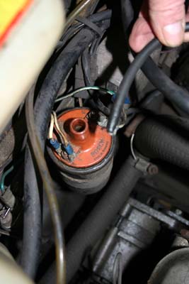

As you can see from the pictures I'm begining to find a few little things that need attention...
Not sure if the lead going into the coil is such a big issue, as i said before she was running fine that way a couple of weeks back.
So it looks like something I planned further down the road will be coming along a little sooner, new HT Leads, Plugs, rotor arm, cap Ummmm not sure what else for now, any thoughts on where best to procure/purchase ?
It became apparent after i removed the rubber sleeve :)
Obvious missing part ?

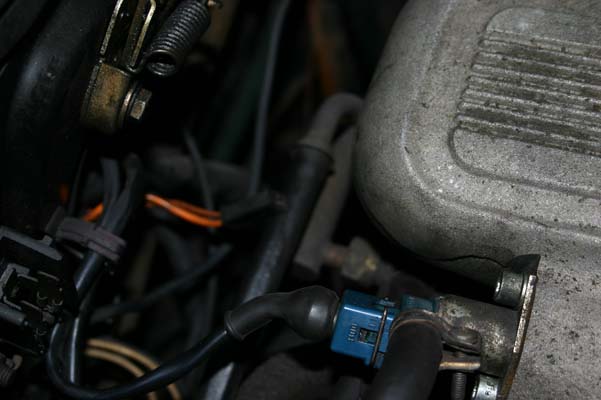

Any thoughts on the Orange wire and connector ? Should it be connected to anything ?

Roger the coil wire is very important and could explain a large part of your starting problem.It appears that the wire's contact has seperated and remains in the top of the coil.Try to pull it out and re-attach it.The Cold Start Valve is wired to the Thermal Time Switch and is grounded through that to the thermostat housing and the engine block.If you visit Greg's site you can find a thorough explanation of where these components are and how to test them. http://www.hiperformancestore.com/Ljetronic.htm
