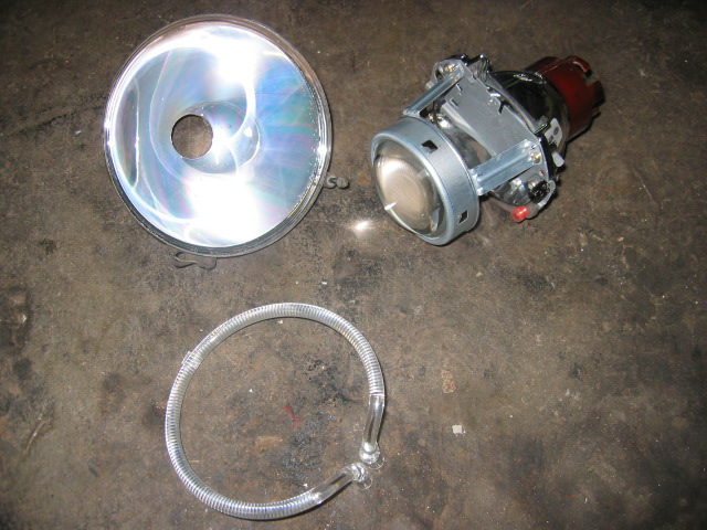

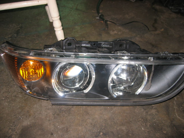

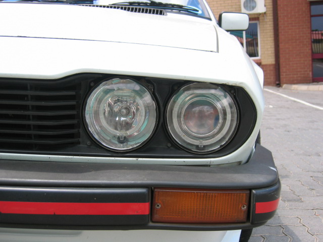

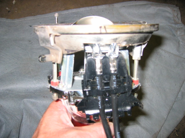

These are pics from ages ago when i made angel eyes with the BMW projector lense and added XENONS.
Re: Angel Eye Headlights

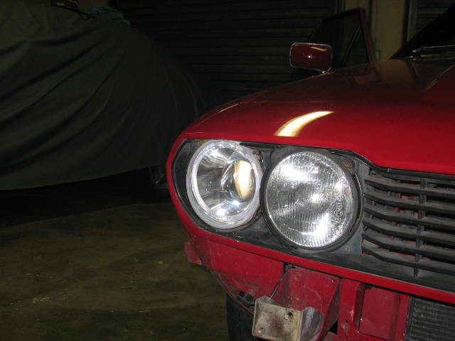

had curved lenses made.

hmm, so it can be done. lots of questions though :)
1) how did you attach the BMW projector unit to the cut down alfa reflector?
2) are the new lenses glued onto the alfa reflector bodies or could you use the original stainless ring?
3) Did you have to make any changes to the alfa switch relay and wiring?
4) the way the angel eyes are fixed to the bmw projector unit, is that original?
lastly are the backs easily accesible still?
sorry for all the questions, but looking at your pictures, it doesnt look like too bad of a job to build these (assuming you can source BMW lamps from the scrap yard)
great look too
1) cut back of alfa lense to xact size then epoxied it
2) New lenses are siliconed on as there were no steel rings on these old lamps
3) Alwasy leave switching the same BUT add relay with inline fuse. No loadind on stalks as they will melt. Stalks only activate relay with direct power from bulkhead.
4) No the angels eyes were choped out bmw lense then small holes were made in the alfa lense then epoxied.
PROBLEMS
1) Have to make tube cover to water proof.

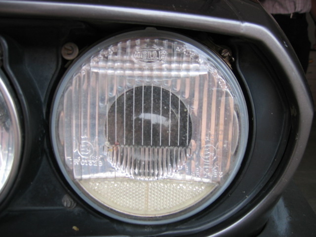

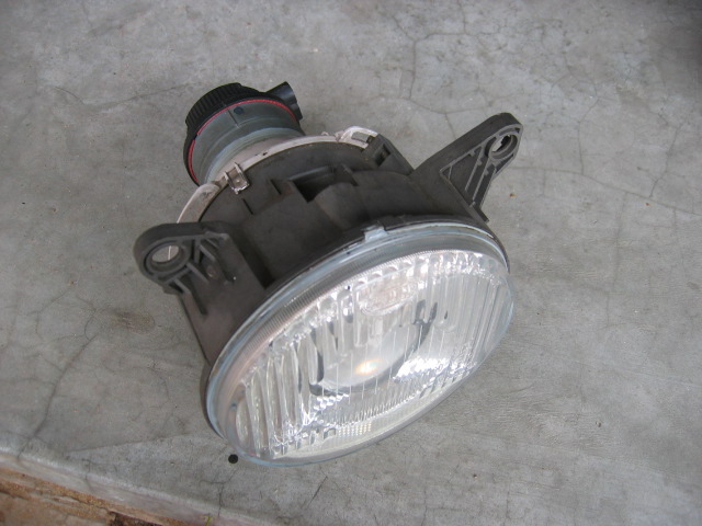

2) WAY to much effort when you can just use the complete old BMW 5(1980's) series lense.
Even though the Bm lense is not curved if I had to recomend going Xenon use this old bm lense below and add xenon. The lenses give the correct spread of light.
To purist its not curved but atleast your Alfa headlight will give you save night driving.
Both conversions you have to trim bodywork slightly inside.

kevin wrote: 2) WAY to much effort when you can just use the complete old BMW 5(1980's) series lense.
Do you remember which type of BMW is this headlight from? E34?
- Alfa 75 3.0 V6 Turbo +300kw -
- Alfa 159 2.2 JTS Berlina -
- Alfa GT 1.9JTDm 16v -
- Alfa GTV6 3.0 V6 24v -
Yes E34 .
