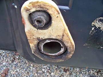

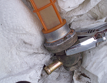

Mats, the tank has to come out because for the second time the fuel filter is plugging with orange/brown stuff. Of course after giving it a go this morning on the main union, it broke free... only to find that what came free was the tanks main threaded fitting ripping right away from the tank :x crap!
With the fuel sock still attached I tried to wrench it free in the vise with a mallet but no go, so I am letting it sit in some liquid wrench.
At this point if I cannot get the threaded ring free of the sock, I'll probably have to get another tank from a wrecker, and then have that tank treated... ugh! Or maybe the shop can do some welding and I just don't use the sock filter :?:
This is why you aren't supposed to keep a car for 27 frickin' years I guess, what was I thinking!
In any case, at least the messy stinky part is done with! GV
And here is the the filter still attached to the ring at the tank, the ring at the tank is what ripped away.
Here you notice the BIG whole that is supposed to have a threaded ring around it which the sock filter than threads into and the union to the fuel line then threads into that.

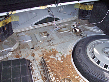

Alfa less gas tank.
Alfa less gas tank.

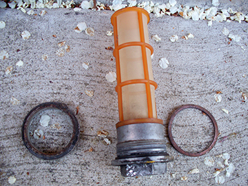

Success - well, sort of. After hammering the crap out of the filter sleeve and the ring that broke free of the tank- it finally came loose - just as I was wondering if the threads were maybe reverse threads. :) The good news is I got it apart and didn't even damage the filter sleeve - the bad news is the part that ripped off from the tank.
So now we'll see if the repair place can weld it back on and for how much $ and also see what a tank would cost from Alfa Parts Exchange. GV
Left ring is the part that ripped free from the bottom of the tank, middle is the filter sleeve, right ring is the copper gasket.

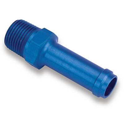

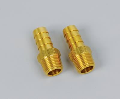

Talked to the shop today, their going to weld in a 3/8" threaded bung for the main line, then I'll go from that to 1/2" or a 5/16" nipple fitting sort of like the pictures below. Summit Racing seems to have a selection. Supposed to get the tank back by the end of the week. GV

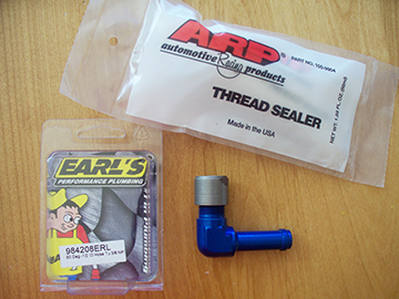

The shop did a great job on cleaning, welding and coating the tank. I was still thinking of using the old in-tank filter and Alfa fittings, but went with the after-market fittings instead. Ordered a 3/8" NPT bung and a 3/8" thread to 1/2" nipple Earl's fuel line elbow for the job.
Am taking the bung over to the shop Monday so they can weld it on the tank, then I'll paint the tank, get some new fuel line and a fuel sender unit and get on with it. From Summit I also got a tube of this thread seal that is supposed to be good to high pressures and gas proof - I'm feeling this will be a good setup once done. The Summit order showed up in one day using regular shipping! GV

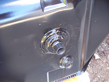

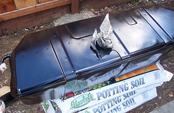

Alright! Got the tank back with the 3/8" bung welded in - they did a nice job. I put on a prime coat and then gloss black. See picts. the tank has never looked so good... too bad no one will ever see it!
Kind of a bummer to spend money on something that doesn't make the Alfa any faster, or handle better or look better - but then again it will run better without the tank filter and main filter plugging up!
Just ordered from Greg G. his fuel line kits for the back rear and the top vapor lines. At first was calculating out what I was going to need... it would have run less $ then Greg's kits to just order the lines for what I needed, but after putting Greg's headlight kit and vacuum hose set on the car I really appreciated how well thought out they were. Plus, I know I'll have everything to do the job... not to mention the 180 degree fuel line bends at the filter and pump.
Still a little bummed to be rid of the in-tank filter, but I think this will be a good set up. GV
Painted up and ready to go back in.
3/8" bung welded in place - in-tank filter is history.
