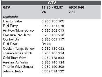

Fianlly, Bosch part numbers for various bits of the L-Jetronic system, not sure if this helps anyone.
L-Jetronic Fuel Injection part numbers.jpg (29.15 KiB) Viewed 10217 times

Have a Bosch Fuel Filter in my hand...
Bosch 0 450 905 030
GV

GregoryV wrote:Have a Bosch Fuel Filter in my hand...
Bosch 0 450 905 030
GV
That sounds more like a Bosch part number to me (then the other listed above).
