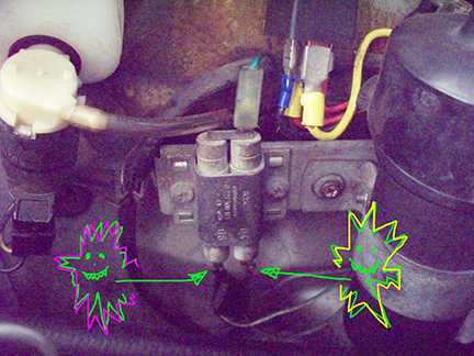

:D The intermittent Cut Out Gremlin has been caught, thrown in a bag and CRUSHED! You know the one, car is running perfectly then just cuts out and dies or surges for no apparent reason. And of course it wouldn't just die for good. Nooo, that would be too easy to diagnose then!
A few years back it was the Bosch Injection Relay acting up and that seemed to take a number of months to figure out. This one had me for the past six months :evil:
I thought I had checked the underhood wires all around when the problem first came up, but yesterday while the v6 was idling I wiggled the bottom wires of the resistor (next to the ignition Amplifier) and the car just died :D Man, was I happy! Trying it again sparks arced to the other terminal which was also lose, and the car died again. Crimping them down with pliers didn't help, so the old connectors were cut off and new ones crimped on.
Time to run it through the gears! GV

I know this is an old thread but I wanted to post a reply & thank you.
My GTV6 started exhibiting an occasional hiccup. So brief I couldn't tell if the tach was dying first (likely ignition fault) or the hiccup was first (likely fuel fault).
Yesterday it hiccuped then a few miles later it died. I coasted to the side of the road and tried the starter & it started right up. It wasn't running right so I nursed it back home and began the search for a solution. A link from the AlfaBB lead me to the above post. Voila - one of the connectors at the resiister was loose. Not just loose but actually off the terminal and just touching it.
Re-connected and all is well with the world.
Truth be told I have myself to blame. A week prior I had R/R'd the alternator. To do that I had to remove the coil & its bracket to squeeze the alternator out & in. I must have knocked that connector off the resistor. It was amazing that it ran fine for a few days then only the occasional hiccup for a few days before it decided to finally reveal itself.
