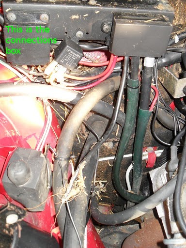

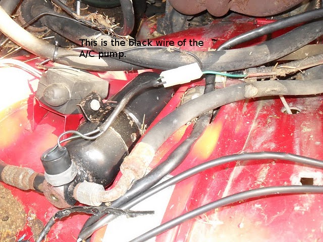

I have a problem with several wires ..
The air conditioning pump out a red wire that connects to a sensor that goes in the tank for air conditioning. Along with the red wire connects to the tank a black wire that is cut.
Wiper connector appears black wire is also cut off.
In a connection box above the wiper comes a green wire, which is next to him, a black wire with a spade connector. This cable is also cut off.
Finally, this junction box is connected white wire is also cut off. Do you know where it goes?
Do you have any idea how to connect these black wires?

That wiring is partof safety system so that when AC fluid/gas is low, system shuts off to save pump.
If I were you, I would really concentrate on getting the mechanicals corrected (timing belt replaced and tensioned correctly). CHECK OIL LEVEL...then main engine wiring/fuel pump, injectors, starter..etc..and then worry about accessories. Get the engine running first. Check the trans...
This way you know you have something to work with.
and, More than likely, your ac gas has already leaked out....
