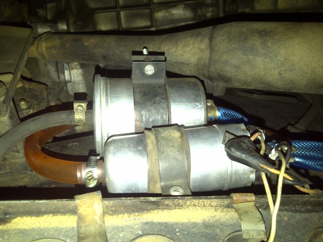

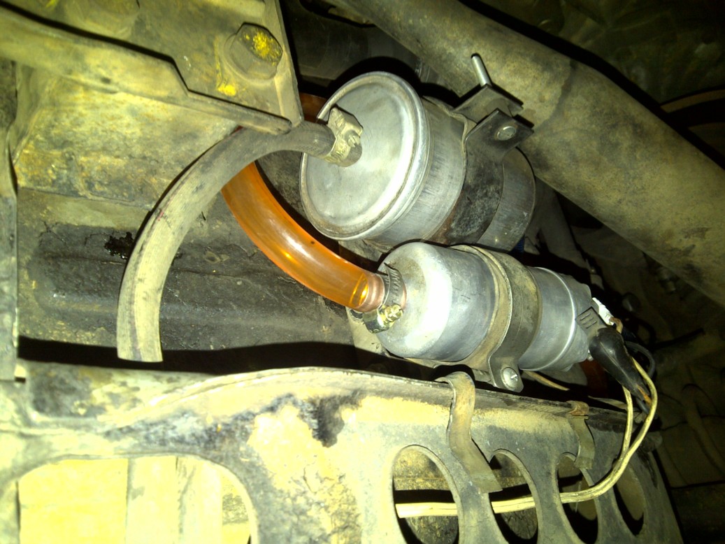

Finally remembered to reply changed the location of fuel pump and filter a few months ago. Now up to date I have had no problems De-Deon comes close about 10mm from filter. At least there are no tight turns in pipe work to restrict fuel flow. No drilling new holes just swopped mounting brackets around and used excisting bolt holes.

Mark, you are absolutely right about silicone. It can never be used for fuel. Silicone hose makes excellent vacuum hose, windshield washer hose, and in certain cases, unbeatable coolant hose, but never fuel line.
On that subject, the amber line attached to your fuel pump isn't automotive fuel line either. That should really be changed. Any single layer hose is risky in that area.

Totally agree with you Greg . Also mark if you decide to travel through the Karoo that pipe wiill totally collapse from the heat off the Tarmac there . It happened to my mate.

Agree wrong choice of fuel line.
Kevin, if you want to prevent a tube from collapsing, it is a good idea to slip the tubing into a long coil of wire that is a close fit on the tube. The wire acts like a brace and the tube cannot collapse.

Hi Guys, i agree with you the reason that pipe is there, I could not find any 12mm fuel pipe any where. The pipe actually comes off a fuel syphon pump, it was the only pipe I could find. It's amazing how a temporary mod seems to find a more permeant place as the memory fades. I will renew my efforts to find a suitable replacement. once again many thanks for the help.
