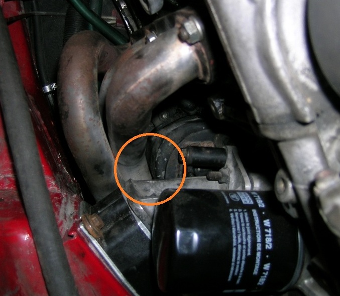

Hello!
I have a problem with my CSC headers and starter.
On the right side, the header is very close to the starter, approx. 5mm.
Is there any chance to get a smaller starter from an other car?
Thank you
Manuel
Re: Smaller starter for V6 - to close to CSC header
You can always remove header and with bit of heat press it in another 5mm then use proper insulation wrapped on solenoid. I have done this and had no problems with starter . Or you can add another flange welded to headers but then you have to bolt header on , not use studs as it's impossible to remove.

hm, the gap is very small, here is a picture of it.
i will try with heat insulation.
