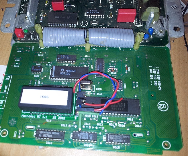

Using my hardware, the ML4.1 becomes a true real-time system so no emulators are required.
With a standard factory bin, an eprom emulator will be just as good as my setup - but my 'custom' firmware will need the real-time hardware for some of the features I'm working on (eg functions like wideband integration, self tuning mode, MAF conversion etc).
I haven't started developing any extended features for the M1.7 yet so your safest bet is an eprom emulator like the Moates Ostrich 2, a copy of Tuner Pro 5 RT, and the correct xdf file.
I'd also strongly suggest a wideband O2 sensor/gauge if you don't already have one, otherwise you're flying blind with the fuelling changes.
With that setup, you'd be able to tune all the basics like the fuel, ignition, rev limits, idle speeds etc.
If you wanted to datalog (it's a bit crude, but that clip shows that it does work) then you'd also need a diagnostics interface and adapter cable (search ebay for "KKL" and "Fiat 3 pin adapter", expect to pay about $20 for the pair) and the Motronic plug-in for Tuner Pro.
If that xdf I put together doesn't match your ECU, just send me the details of yours and I'll see what I can do.
I'd need the hardware ID at a minimum (0.261.something, will be on a sticker on the ECU's case) - the software ID would be even better, but you'd have to either open the ECU and read the sticker on the chip, or read the ID using a laptop and diagnostic cable.
Here's a pic of an ML4.1 with my real-time module installed:
