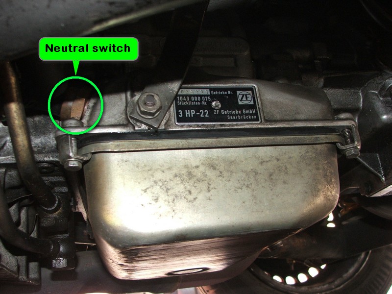

I get to answer my own question due to advice on another forum.
It's is apparently situated in the transmission adjacent to the gear selector. The relevant wires are colour coded black and green with black stripe.

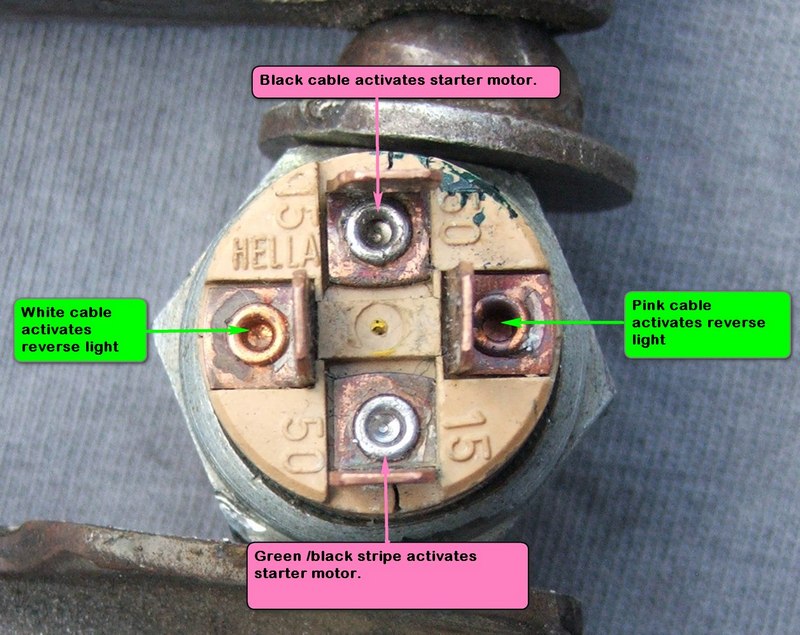

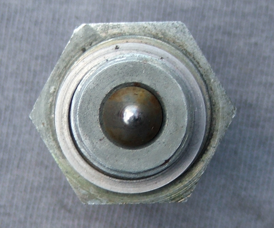

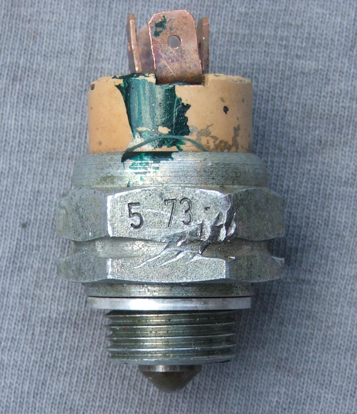

See photo. Note the difference in the proximity of each opposing pair of contacts. It is a Hella switch.
Neutral switch location.jpg (123.02 KiB) Viewed 4659 times
1a Hella inhibitor-reverse light switch functions.jpg (132.73 KiB) Viewed 4659 times
2a Hella inhibtor- reverse light switch side.jpg (234.19 KiB) Viewed 4659 times
3 Hella inhibtor- reverse light switch base.jpg (189.69 KiB) Viewed 4659 times
