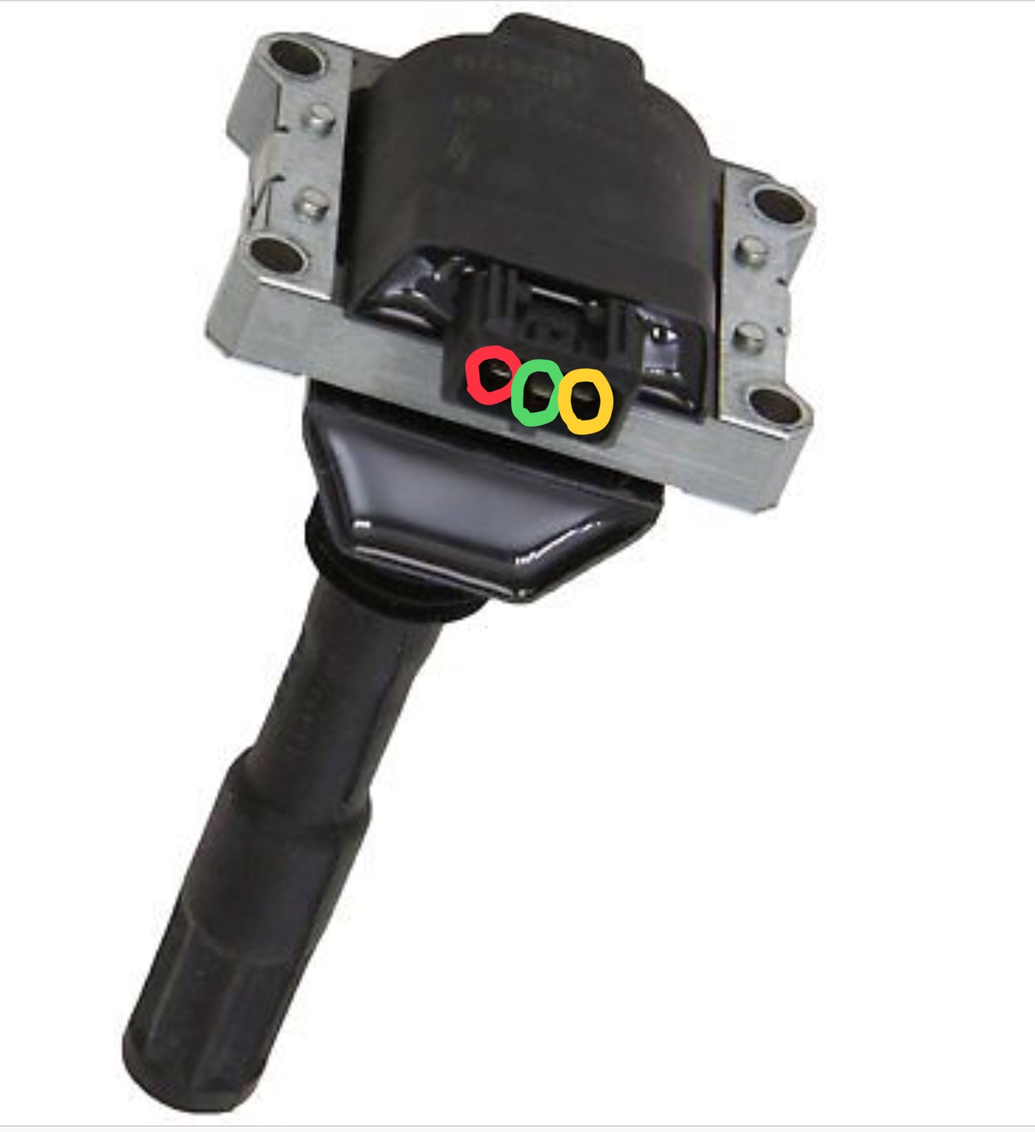

Does anyone know the pin out of the 24v coil pack?

Give me a few days. I have to lift the coil cover on Sunday for start. To get the base timing for #1, I am going to rig a dummy coil up to connect to the harness. I need to know exactly this myself.Does anyone know the pin out of the 24v coil pack?

I got the info from Beninca. Center pin in ground. I'll paste the photo later.

When you say "Centre pin in ground", do you mean grounded to engine or trigger?
I am using the injector and coil harness off a 166. On this harness, power goes to the pole you have circled in red, green (centre) is earthed to the engine and yellow is the trigger. Having said that I have not got a spark yet. As #1 is under the plenum, I am jury rigging a spare coil to set the base timing.

The green pin is GND. Yellow is trigger.
What ignition system are you using? Are you using the Bosch 203 igntion module?

Haltec HPI 6.
I am not getting a home signal. I am not completely sure on the Signal, Power and Ground pins on the cam angle sensor (May be stuffed). I ave two, and they both test the same with a multi meter. If you know, can you post (i.e. Red...., Green.... and Yellow....). The plug is the same as the COP coil pictured above. This is the only thing it appears to setting base timing and starting it.
