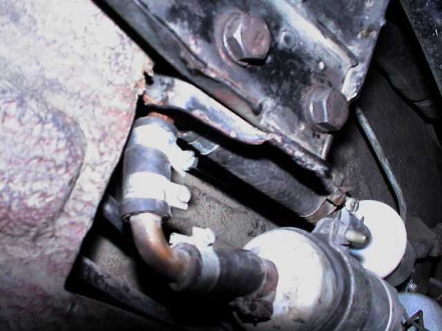

Dave I did my best to take a pic.Basically I replaced the 180 deg.turned hose using 2 -90 deg.1/2" copper plumbing fittings.It has worked out just fine.It's important to size the assembly such that it still tucks up into the space between the dedion crossmember and the car's chassis otherwise it will be hanging down.I also added an in-line fuel filter between my FI pump and the tank to ensure that the pump doesn't get jammed with any garbage floating around the system.I had that experience and don't care to repeat it

Dave no I'm not concerned about corrosion of the copper,it's a spring-fall only car and the copper seems to be holding up just fine.Yes I've got filters up and downstream -nothing is going to get through and jam my $ 300 fuel pump again !
