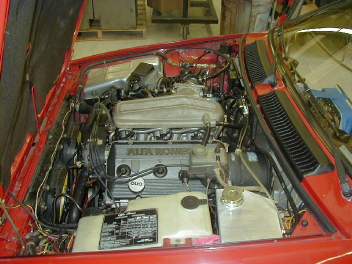

Well I thnik now I have really found the problem! Last week I put on the aluminum coolant resevoir tank I got fromIAP. It is absolutely beautiful (albeit pricy). The hsoe connections are a bit different (not much!) from the leaky OEM plastic tanks. The top rear hose to the tank (about 5/16) when connected pulle the hoses it was connected to behind the engine so that those hoses interfrred with the throttle linkage where the linkage from the pedal connects to the throttle cable. Cure was simple went out bought a longer hose and voila no more interference! Terry
Terry

Terry's pix:
Coolant Pic 50%.jpg (149.24 KiB) Viewed 9410 times
Second Pic 50%.jpg (130.72 KiB) Viewed 9410 times

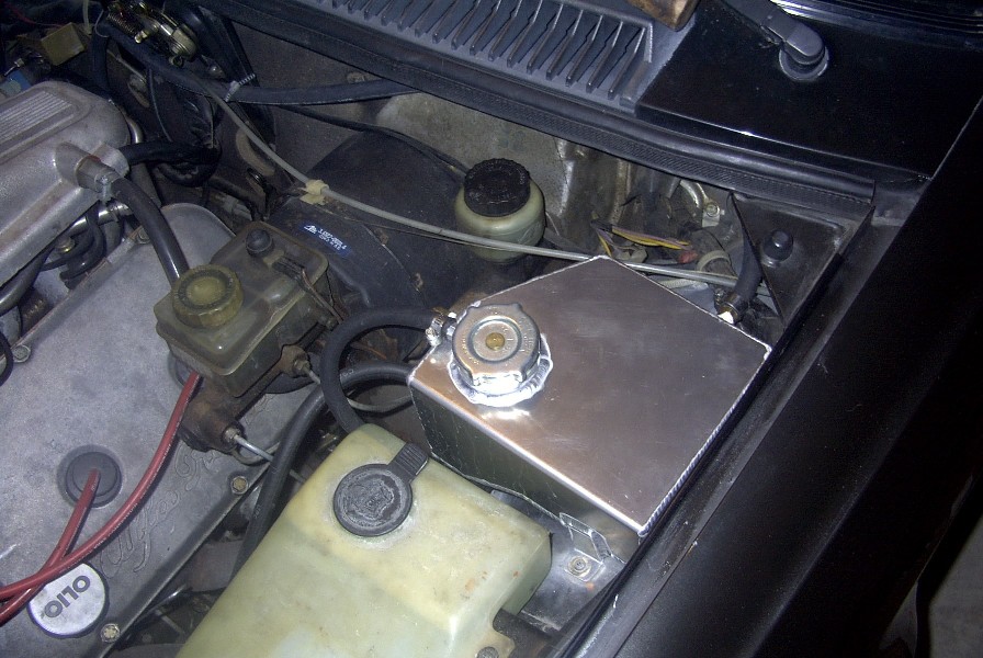

My tank, from Canton. That was before it became an IAP product:
P1010017 55%.JPG (133.29 KiB) Viewed 9406 times
