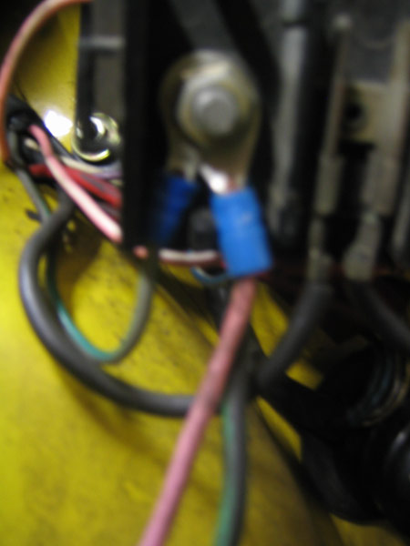

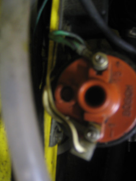

Dennis
Posts: 194
Post by Dennis »
First. Connect the pink/white wire from the motronic loom directly to the pink/white wire from the fuel pump. Then connect the pink and green/black wire to the grey/green wire from the ignition switch. You're done on this side.
Connect the green/black wire to the + of the coil and the white and black/white to the - of the coil. That's it, start her up!! After you check ALL grounds off course :wink:
