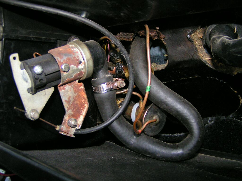

Approx. a week after my last post in this topic I've installed the Alfetta valve, and I can happily say that it performs great!
Some minor modifications were necessary, but it could be carried out easily.
-The first is the arm that makes the piston move has to be replaced with the GTV unit (or simply just turned around, since they situated symmetrical.
-The second is the metal sheet that holds the wire housing in place. Thats only a 4 mm bolt, and a simple bolt-on process.
-The third is the connection to the heater. The distance of the bolts on the GTV heater is closer than on the Alfetta valve. What sould be done is to make a little (some mms) offset of the holes on the valve with a cilindrical rasp or a dremel tool.
As a gasket I've used the rubber one from the Alfetta, and it seals good. There is no leakage.
This is the valve from the Alfetta Sedan. Note the difference in the arm' position and the wire housing holder.
Here you can see that the valve's seat is a bit larger than the one on the GTV heater. The difference is not exreme so it can be modified with simple hand tools. For turning or changing the arm the factory pin has to be damaged. Here it is substituted wit
A longer hose is necessary since the head is turned 90 degrees downwards. The Hoses of the AC are not connected yet, but there is still enough place to accomodate.

Ingegnere,
Good information.
One concern is the kink visible in the hose at the bottom of its loop. It will eventually fail there although it may be years in the future. Inserting a spring inside the hose would probably stop this as would a larger loop.
Your last photo shows the brass colored ring that I cut apart to graft the alfetta valve on to the GTV6 base to retain the proper orientation of the outlet. I also drilled out the shaft that holds the arm in place and was able to install the old arm and the temp sensor. Actually, I left the sensor from the original valve in the car and will capture it in the new valve before I assemble the old arm to it.

Thanks Shures,
and you're right. Where the crossectional area decreases in the tube, sometimes I hear the water "floating" inside. :? So I assume this as a temporary solution, I will change the tubing when I install the hoses of the AC.
But on the other hand, I use heating only in March and Sept, because in winter it's laying around in a garage.
What you're carrying out is interesting. I was thinking of the same, but mine GTV valave was broken at that 'useful' part, where it connects to the heater. And I was also afraid of casing problems. Can you solve it securely?
The arm and temp sensor is used form the GTV as well on mine, at least because I did't want to dismantle the whole heaterbox to take out the thermo wiring. :roll:
Waiting for your pic, and good luck. :wink:
