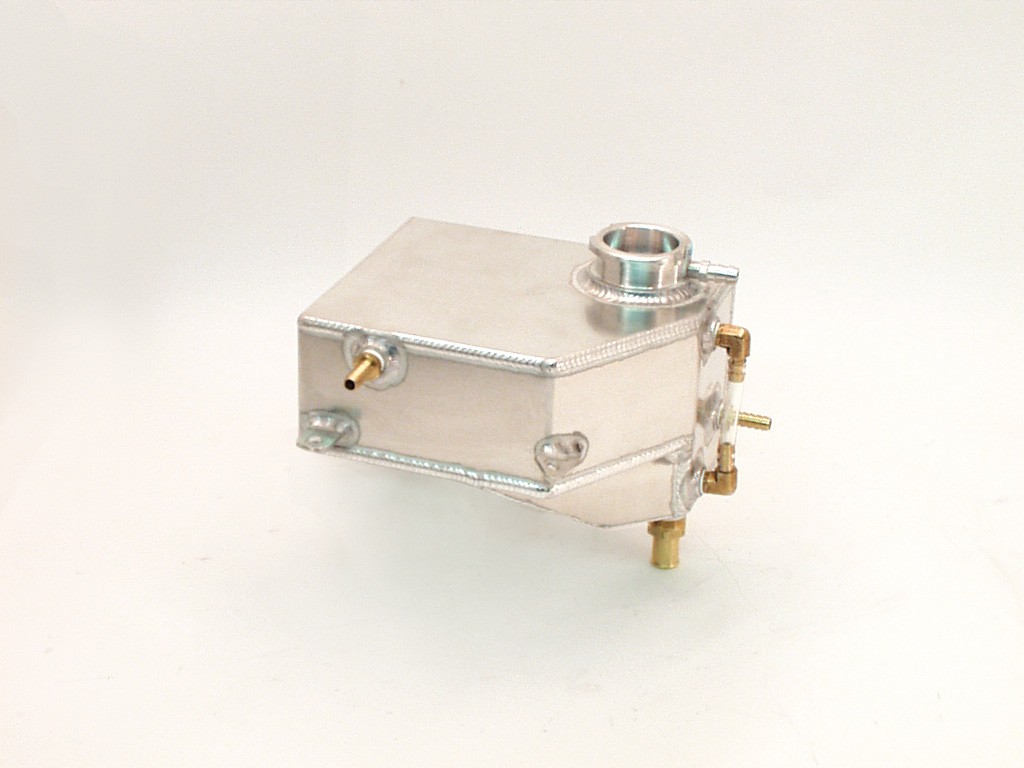

I got my answer today, they have shipped, but there maybe a slight mounting problem, David said it maybe cured with plastic shims, so when mine shows up, I will let everyone else know. Here are the pics he sent!

Post by SamW »
Michael, from what I was told, the new tank was made from a jig that was made from the original, but someone has already received the new tank and tried to install it and the two mounts closest to the outside of the car line up, but the lower one closer to the engine did not line up, something to do with the structural reinforcement the tank fits over, from what I understand/was told, a shim or two under all three mounts should take care of this. I am ok with this as long as the additional height does not interfer with anything, I think a few rubber washers under the alum tank would be a good idea anyway for heat and scratches.
SamW
Posts: 260
Location: Kingsport, TN
Post by SamW »
Bad news, looks like the tanks will need to go back for modification, all the mounting tabs are about an inch too high, too much to shim, unless you use a 1" spacer, but the mount closest to the engine is at an angle, so a spacer won't work. The only other mods that would make them better would be to cut an angle out of the corner below the angled mount, and maybe angle the bottom edge closest to the fender, here are some pics of it in my car, maybe you can see what I am talking about. I will call david tomorrow.

Perhaps the 1" spacer issue is not such a big problem. Using isolation mounts may solve this. See the attached pix. Solves the paint abrasion issue. Also will prevent fatigue of the alu mounts.
The angled mount though....that'll have to be sorted.

Post by SamW »
If we could get those about an inch and a quarter they would work, then just bend some alum stock to make an adapter for the angled mount, a hole on one end and some sort of nut on the other end for the tank mount. The space between the mounts and the mounting points is 1.15 inches, another 1/10" would raise the tank off the sheet metal of the car. And raising the tank that little is not a problem because the tank is about a 1/2" lower than the plastic one. Can you get those spacers with a sheet metal screw thread instead of the machine screw thread, at least on the side that mounts to the car?
