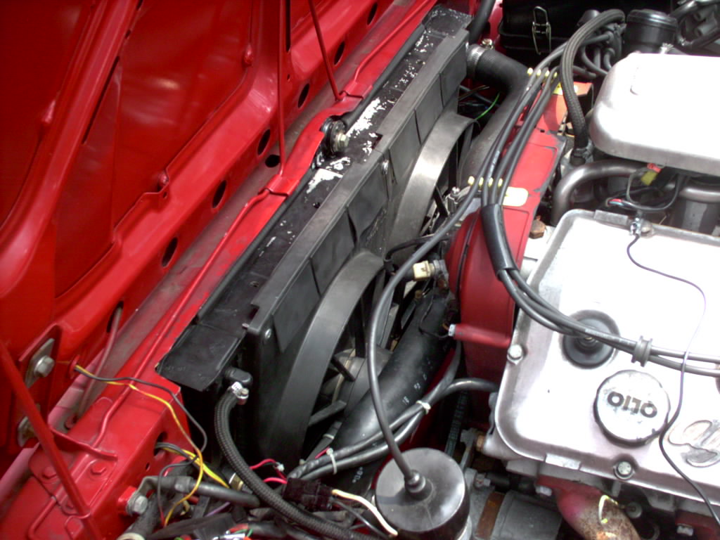

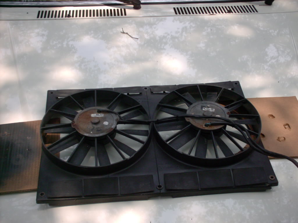

Here's a good & easy solution for cooling. My Maserati Biturbo has a pair of air-to-air intercoolers in front of the condenser and radiator like you are doing. Get a tropicaire A/C radiator fan set up (or the others will do) from a late Biturbo. It will literally fit the GTV6 radiator. It's the same one that the Callaway turbo GTV6s used. I paid $60 USD for mine and in fact bought another for spares.
Install is simple.
1. Remove the old fans that suck anyway.
2. Swap the plastic electrical connectors off the GTV6s fans so they'll mate.
3. Slightly raise the Radiator with just the mount bracket removed and disconnect the temp sensors to allow more room.
4. Slip the bottom of the Biturbo fan shroud under the radiator and return the radiator to place. It is a TIGHT install fit, but is fine after you get it in.
5. I used 3 self tapping SS screws to attach the shroud to the radiator top extruded flange.
I haven't seen the car run hot yet in the hot AZ & FL summers in traffic with the A/C or spirited runs. These fans rock.
