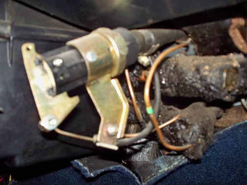

Hey guys.
I'm having problems with my heater valve it stays open, and there's always heat coming out of the vents.
I think the problem is related to the metal bracket that activates the plunger in the heater valve. I think mine is not installed in the right hole or is orientated incorrectly. Can someone take a pic or two of the heater valve area. showing the metal bracket that is connected to the cable.
thanks

hello lads,
It's getting very hot here in toronto, still no luck with the alfa. it's too hot inside now to drive. I've got to figure out why my heater valve isn't closing.
So i'm asking again hoping someone can take 10mins out of there day to help
me out.
can someone please take a picture of the heater valve area showing the cable going to the arm that opens and closes the vave. I need to see if my arm is orientated properly.
Thanks
Greg A

Yes this does sound very complicated. I would like to see some pictures of the whole setup.
Anyone know a source for a new heatervalve?
can someone PLEASE take a picture of the heater valve area. I need to see if the metal arm that activates the plunger in the valve is set up properly.
Untill this is sorted out my car is sitting in the garage wating for a colder day. even with the a/c cranked it's still very hot.

If you put the cable/ wire into the hole closest to the pivot point you will get the most "action" out of the valve....it will also be the stiffest / hardest to move.
hth,

Here's a picture with the vlave in the OFF position. As alreasy mentioned make sure to adjust so valve is all the way OFF, don't worry about getting Full On, these heaters put out some serious heat at just 3/4 open. GV
- valve.jpg (88.92 KiB) Viewed 13789 times

well,
i've compared my setup to the picture and it looks like mine is in the same holes as in the picture. so bad news i guess. Anyone have a source for a new heatervalve?
