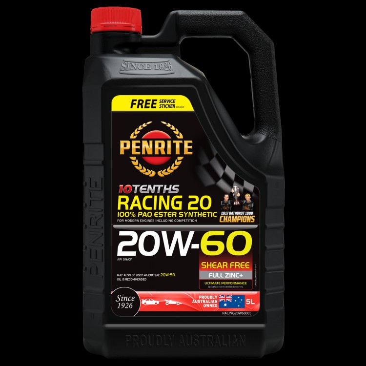

First you need to tell us if it is a dedicated track car because too much cooling will be detrimental to a street application. Failing that, just switch to a full synthetic oil which will handle that temp and do nothing else.
- 20W60 Synthetic.jpg (76.99 KiB) Viewed 8300 times

Yes, the car is used exclusively on track.
Already using a full synthetic oil. Amsoil, but i would prefer not to turn the thread into a which oil is better debate.

The brand of oil is largely irrelevant. Penrite is just an example commonly used here is Oz.

Oh I didn’t know Penrite oil was established in 1926, were you around 16 that year?
