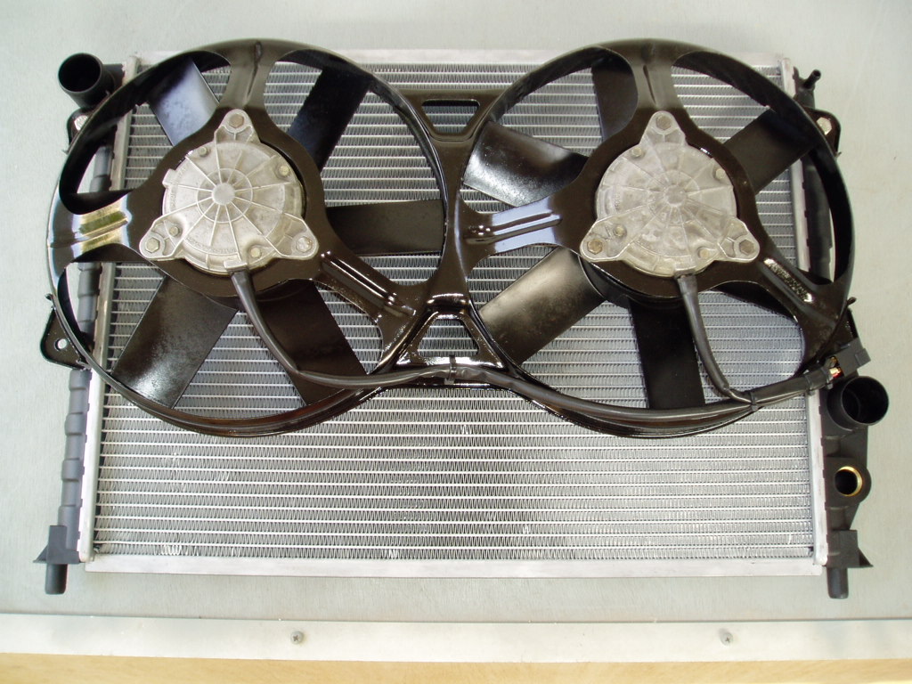

Why not try something like this? The A75 TD setup.
A75 TD setup with rare factory aluminum rad.

For the rad I paid 114Euros (dealer price) but regular price was 175. The twin fans you can get from a used parts store as I did (90Euros) and then rebuild them (no parts required, just cleaning the inside of the motors,smooth out the the collector and brushes, grease the bearings and thats it.
These aluminum rads are very hard to come by now, but the std TD rad should be available new (same size).

Who made (makes) that alu rad? I ended up putting a new stock 3 liter rad in my 3 liter milano a month back. Ran well at Oct TT in the CA desert (WSR), but then again, it had cooled down some by then.
Its a Spanish subsidiary of the BEHR company (German firm making all kinds of excellent quality rads and thermostats for all kinds of cars)
The box has the p/n AL2031 on it, but nothing related turns up in the net.
This rad has Alfa90 and 75 TD application and the bottom pegs fit the 3liter if you use a 55Ah battery and cut a ~2" V shape notch in the tray. Good idea to enlarge the front sheetmetal window to expose the whole surface and fit a heavier duty 40A relay with bigger gauge wires straight to the battery or starter motor terminal.
