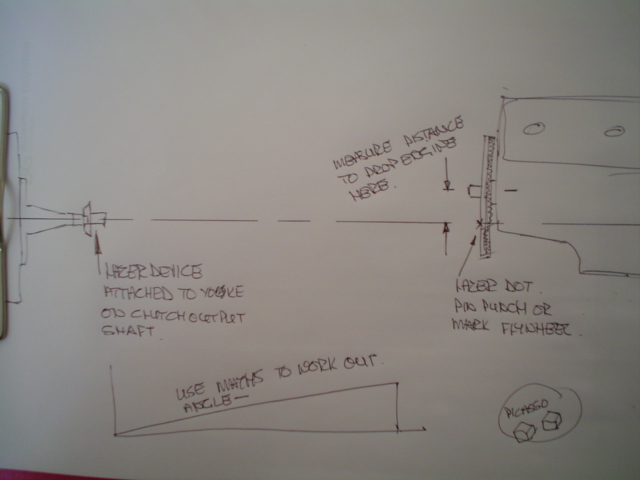

Guys,the shaft does run out of line here..A simple way of checing it is to use a 5dollar laser pionter.I machined a goody up that fitted to the clutch spigot and yoke and mounted the laser.switch on and measure..You got to drop the engine a load to get it straight..
Mike,this we did with Jose`s car,the one I sent you the pics of..

If your laser set up does that, don't leave town, I am getting a Quantas flight over :!: :!: It may well do but as I say, I didn't get that from your explanation. So let it rip son..
If the center of the engine flywheel is pointing at the center of the clutch flywheel and the other way arount they are perfectly aligned. :wink:

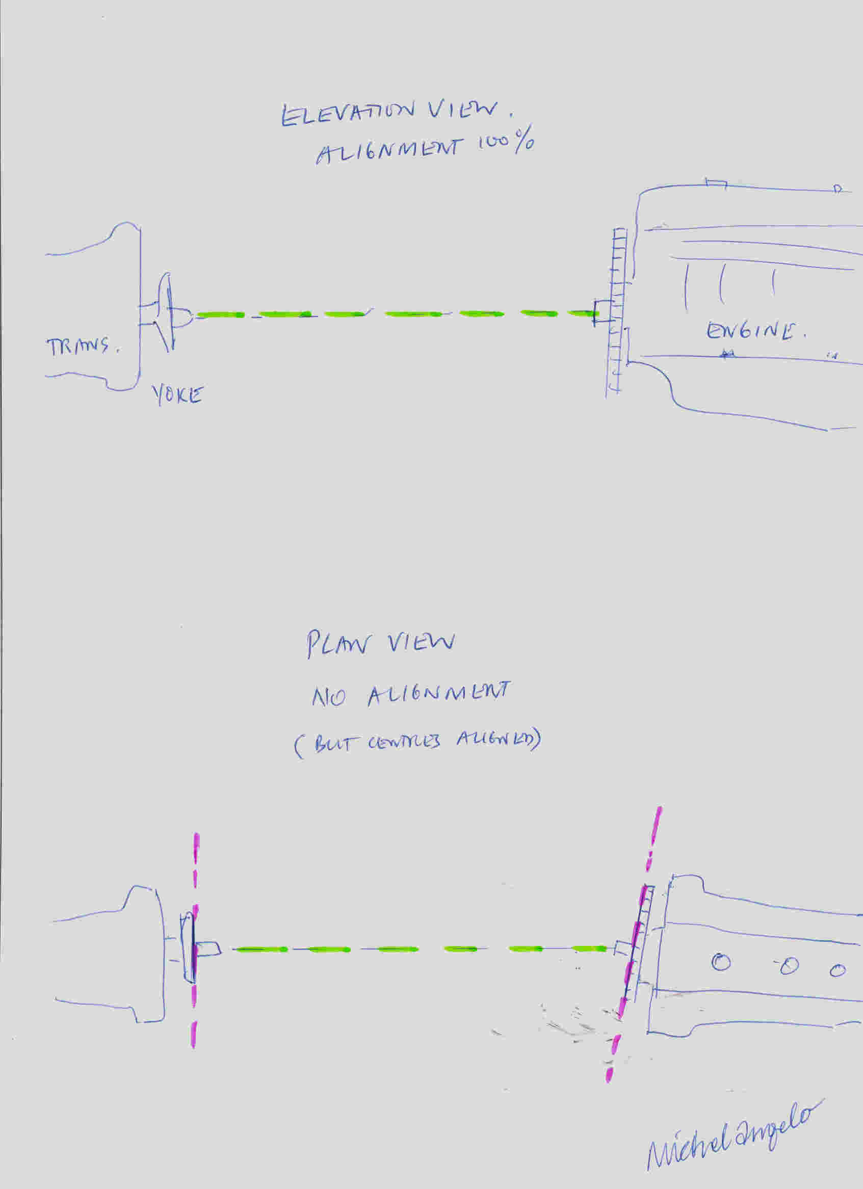

One more go to get the point across Baz.
Refer to diagram by Michael Angelo below.
In the Elevation View, the centres are aligned and assumes a face to face parallel conditon.
In the Plan View, the centres are aligned as before but due to say the sideways torque movement of the engine, the faces are now not parallel even though the centres are aligned.
It's having to set the optimum angle of 2-4 degrees for universal joints in both the elevation and plan conditions simultaneously thats the bug and then trying to keep it in that conditon for all operation conditions of the vehicle.

Oh dear. I'd fogotten about the stupid bloody angle the Alfetta motors are mounted at :(
Too much Vino by the designer? or was the welding jig builder the culprit?
Nothing you couldn't fix with a welder/grinder/powerdrill :P

Yes,the engine is slightly skew,but nothing that cannot be fixed..A simple way of checking how skew it is,is to put a broom stick cut to about 1 ft. in the flywheel...(This is now a South African b/stick as per mother in law issue here..)It will show up immediatly..
Mike,as for movement during operation,well,the tighter the mounts and all other goodies,the less movement..Im now talking replacement mounts as we have now dropped the engine lower(I use ,amongst others,1970 circa Ford f100,f150 mounts..)Im actually l;ooking at some Mazda 20l mounts...Theres a s.load of stuff we can use...
Note in the pic above,Jose used a type of torque bar...
