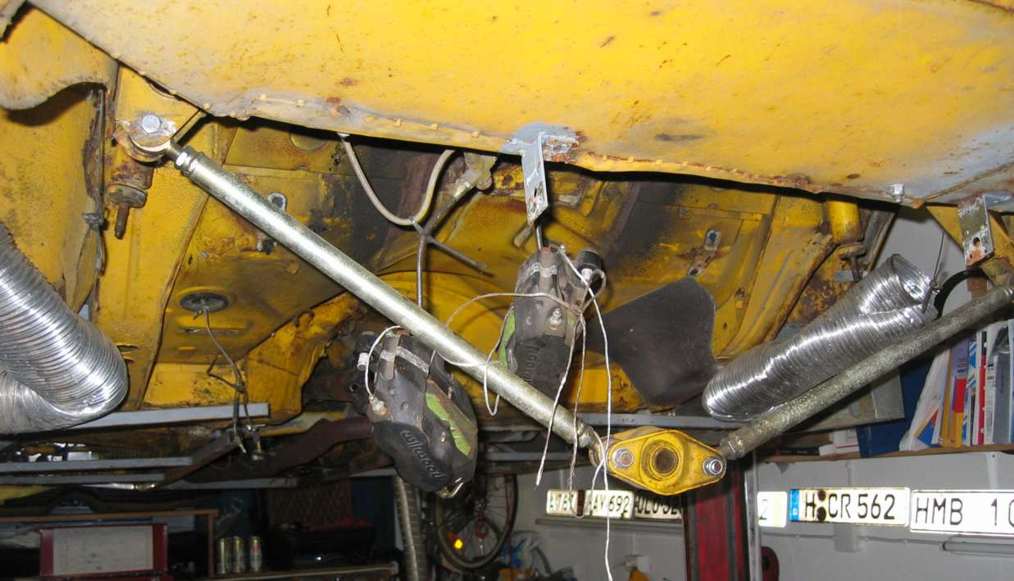

Carson pulling the whole dedion/transaxle is not difficult and will give you an opportunity to thoroughly inspect and clean up everything back there.
Basically you have to:
- Lift the rear of the car as high as possible and support it on good solid jackstands.
- Remove rear exhaust.
- Disconnect driveshaft rear coupling and shift rod.
- Disconnect watts links to chassis connections.
- Disconnect hydraulic lines to clutch slave and rear brake calipers.
- Disconnect parking brake cable.
- Disconnect shock absorbers.
- Remove 6 bolts connecting front crossmember to body.
Next you need to use something to support the rear of the transaxle to prevent it from dropping down into the dedion triangle and stressing the axle halfshafts.I used a strip of flexible plywood which I fed over the dedion tubes and under the transaxle. ( see image)
Now you need to position (ideally two) hydraulic jacks under the transaxle,one at the front and one under the differential.The final step is to undo the bolt that runs through the rear transmission support and through the chassis.Make sure your jack is securely supporting the assembly because once this bolt is removed she's coming down !
I was able to get my car high enough that I left the wheels on which made rolling the assembly out much easier.
Hopefully I haven't missed anything !
Once you get it out you'll be really glad you went this route
