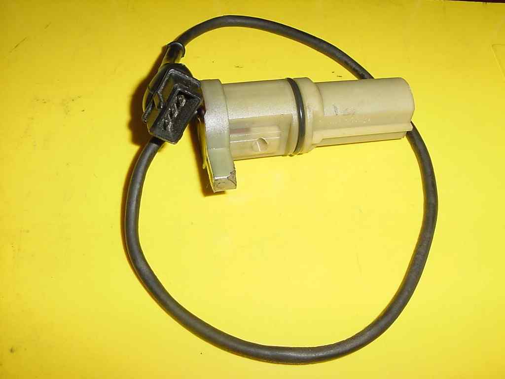

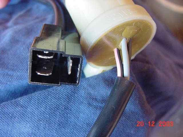

Here's a link to start with :-
http://alfagtv6.com/bb/viewtopic.php?t= ... eece7ce8b9
Then walk through the following photos that will help you further.
The first photo shows you the progression of the electronic speedo drives from the earliest type to the last of the series.
The second photo shows a two wire sender with the Bosch type connector and having a yellow and brown wire. It is used together with the Jaeger black box amplifier located under the 75/milano back seat.
Finally, the last photo shows a three spade connector type sender. This unit contains inside it all that is held in the Jaeger black box so it is all self contained and must NOT be used with Jaeger black box. Just use it by itself.
You cannot use the earliest sender type because it requires a gear drive which the TS box does not have.
The remaining 2 & three wire type senders must be used in conjunction with a Dakota type translator as detailed in the above link.
I hope that clears it up for you.

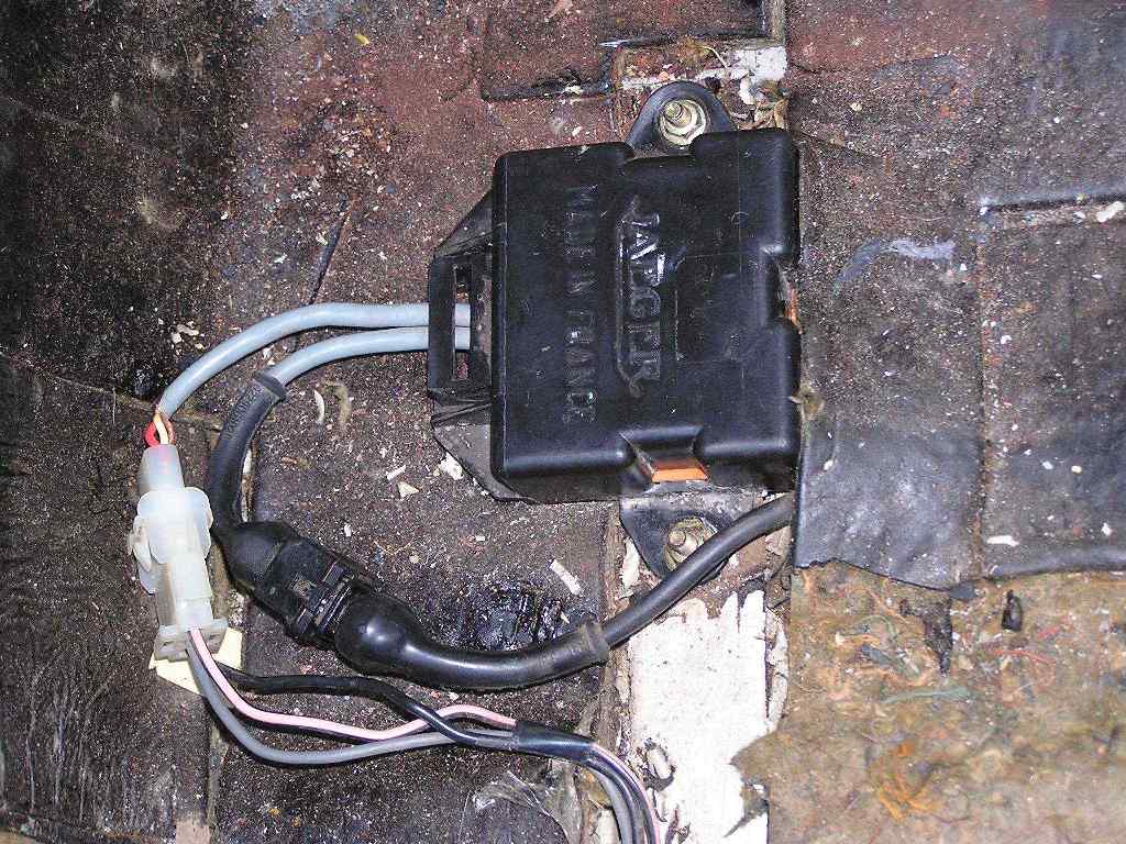

In case you haven't seen a 75/Milano Jaeger black box located under the back seat, here's a photo of it.
People call this an amplifier but frankly it is a lot more than just an amplifier..
Jaeger B- Box components for 2 wire sender in TS 75.jpg (236.3 KiB) Viewed 8174 times
Jaeger Black Box in 75 Twin Spark.jpg (127.91 KiB) Viewed 8171 times

so then i just need a sender and the dakota sgi5? and that i dont need the milano jaeger box
or are you saying that the 3 wire sender doesnt require a jaeger box? but still will require the dakota?
i read what you said 3 times and think thats what your saying
OK, let's recap.
You need a Dakota in all cases.
You can use a two wire bosch connector sender plus a Jaeger black box from the 75/milano + Dakota
or
You can just use the three wire sender + Dakota
I cannot make it any clearer.
