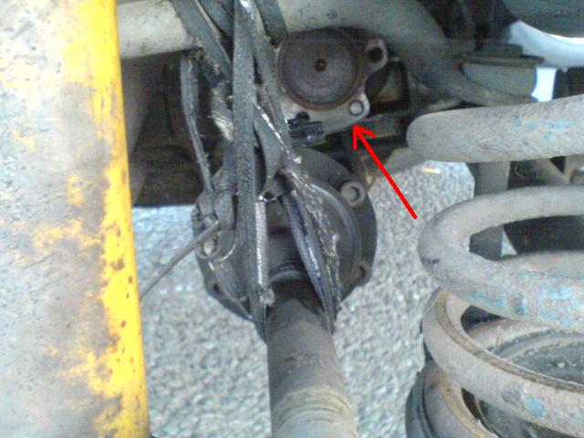

Refreshing the topic a bit as I will be soon doing the same thing... Shortlife you mean these?sh0rtlife wrote:you will have to swap out the rear axle stubs(for lack of a better "alfa" term the short output shafts exiting the transaxle) as the bolt sizing and i think some offset is different

- DSC00651.JPG (53.36 KiB) Viewed 11091 times
Offset is the same, bolt size is different - either M8 or M10.
There is a spacer that fits with the shorter half shafts/drive shafts which I think are the ones with the bigger bolts (GTV6 & 90 ?), while the 75TS has the longer shafts, no spacers and smaller bolts.
The PCD of the holes on the stub shafts is the same, just the size is different, so worst case you could drill and tap them M10 to suit the short shaft and spacer setup.
Maybe mine was easier because I replaced a GTV 2.0 trans with a 75TS trans and the shafts and bolts were the same.
