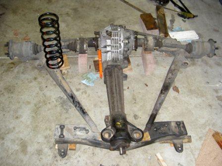

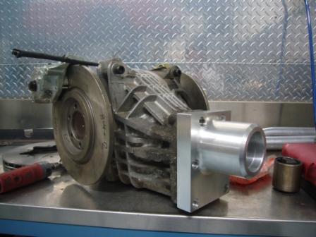

Barry and Remco have provided spot-on info regarding the Getrag and the Sei diff, as my brother and I are part way through installing a 3.0L into a Spider, complete with a customised bellhousing and deDion rear end with a Sei diff.
Not a transaxle guys, so please don't shoot me down in flames......
I've tried to keep a diary of the project over the last two years or so on the "other" Alfa BB (tucked away in Engine Conversions, posting "Alfa V6 into 73 Spider). At the moment, we've just about completed the Getrag install, and the deDion and Sei diff install is really beginning to race ahead.
Barry, you're right about the Sei diff being really heavy, but we've ditched the cast iron diff nose and made up a billet Al one, saving around 15kg (35 odd) pounds. Now we're tinkering with adapters for the diff to the driveshafts, and we may try to make the adapter act as a hat for a set of vented rear discs.
Here's some photos of the Sei rear on a standard Milano/75 dedion, and the diff with its new Al nose.

Re: Alternative gearbox for 2.5 or 3.0
Home made torque tube, impressive.
Have you driven it?

Mats,
The Aluminium diff extension will actually have a BMW guibo fitted to the end, mating it to the gearbox using a near stock prop shaft setup (although it would be interesting to have a chat with the engineer about fitting CV joints at each end, as I have been told by some that they would be quieter).
Interesting thought about making it into a torque tube setup, but (as others have said) the heavier weight and balancing the whole assembly would be a real pain.
As to when the car will be on the road.....you could safely say another year or two by the time a new sump is designed and cast, the diff and engine rebuilt, wiring and EFI.......
Dino
But that is a torque tube setup with that extension. :)
Not full length though. Would be very difficult to make that setup work without getting a nice and long bushing span to control the wind-up of the diff. With hardy/guibos anyway.
