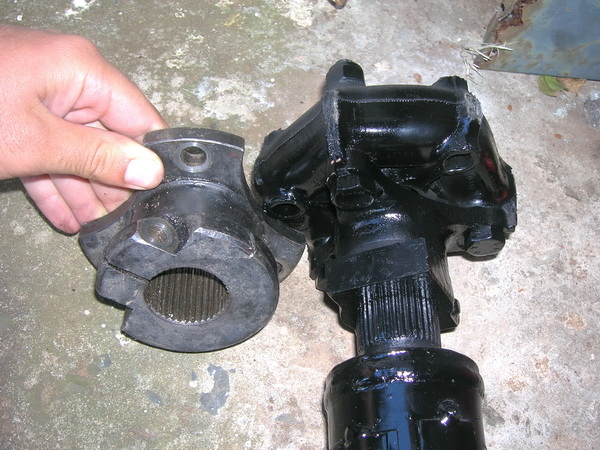

Was it balanced with the front yoke on. There were two types of yokes in South Africa. Im not sure where this second one was made but it very 'eccentrically' made(sorry bad English). post pic.

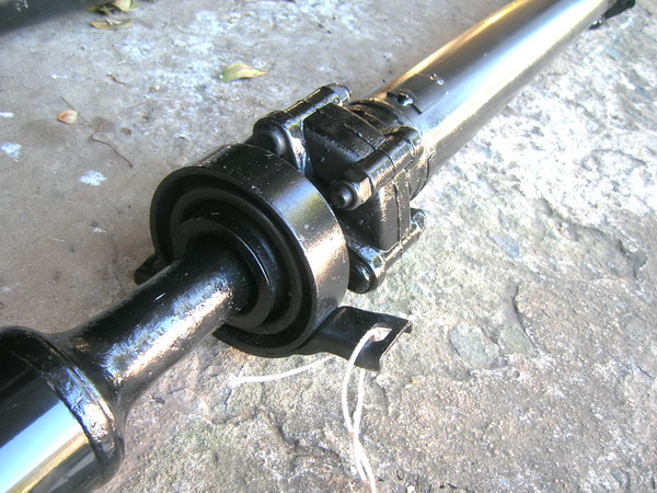

Also post pic of centre hanger. I also had a 159 v6. Great car.

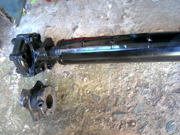

Kevin: Thanks for feedback. Below are a few pics. Originally the car had a round coupling but it felt loose on the splines and I fitted one from a GTV6 which was sent with the prop for balancing. Hanger bearing is standard alfetta.
