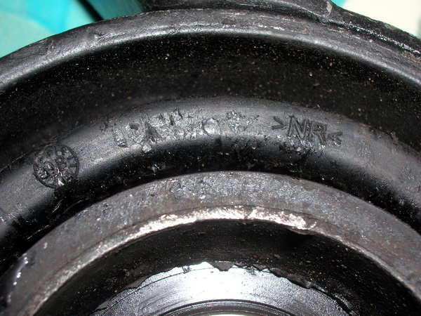

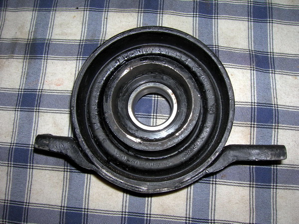

Below are a few pictures of the type of hanger bearing you should avoid at all costs!

Well spotted, who would have thought. Where did you buy these hangers.
