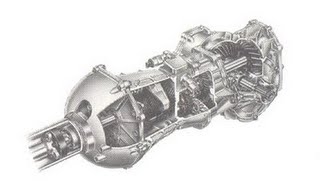

I thought I'd start this so as not to pollute CChans topic. It's also something I'd thought about.
GarthW wrote:I know everyone thinks that once a certain HP is reached, the rear transaxel will blow, well actually it will, but how has corvette managed to hold nearly 600hp with the gearbox in the back..? I know its had a hell of alot more engineering than our gtv6's, but i'd rather spend the cash modifying my transaxel than having a gearbox up the front..
The 'vette answer is a simple 1. They are a Borg Warner/Tremec T56 based gearbox with a differential housing bolted on the back. Simple, big solid transmission design.
GarthW wrote:Would love to know what can/could be done to hold more hp for the transaxel...maybe a borg warner could fit in the back...?
That would come down to coin.
The Borge Warner 'box looks the easiest (compared to say a Toyota W58 or a Nissan 'box) to adopt a cable shift mechanism to. I figured that would be the easiest way to sort out shift issues.
The biggest problem that I see is the gearbox output is at the top where the Alfa gearbox output is at the bottom.
Chev got around this by having the pinion shaft go right across the top of the diff and actually engage the crown wheel at the rear of the diff housing. The only real problem I see is that of lubricating the bearings, so I'm guessing they used a pump of some kind.
As for building a diff housing, it could simply be fabricated out of either steel or aluminium and the machined as required for bearings. That's how most/all of the big industrial gearbox housings are made.
I'd base the diff on a common, strong well supported in the aftermarket IRS based diff like the Nissan R200. If they survive behind 1000hp drag cars, then they would be good enough for 99.999% of any Alfa's ever built.
I'd only ever make the housing like the Nissan design with 2 big main bearing caps that hold the diff in place and an end plate, deffinately nothing like the Alfa transaxle design.
Corvette Transaxle - edmunds.jpg (9.4 KiB) Viewed 8036 times

I've been deeply involved in development of diff-casings and to tell you the truth I would never attempt to do that without the backup of OEM development teams.
There are so many ways to f**k up a case design you wouldn't believe.
Buy something existing and be done with it, it's driving you wan't to do right? 8)

Mats can you be a bit more specific?
I know it's a hell of a comparison, but I see small, medium, large and huge gearbox housings that have been fabricated from steel and then machined as needed.
1 of those gearboxes is attached to a 5000hp DC motor for the 1st stand at the rolling mill that we have where I work (we make steel from ore to some finished products like rail (for train tracks) and structural steel for buildings aswell as about 200 specialised grades :wink: ).
I would love to see a practicle means of adressing the transmission strength issues of the transaxle Alfa's, without having to try and get a Corvette unit.
Re: Borg Warner Based Transaxle
Well, first of all, if you want something that is even remotely light enough to attach to a car you need to know how to dimension all the parts like bearings, housing wall thickness and stiffness, gears, bolts and such. You also need to know how to design a final drive, assuming you use an existing hypoid gearset you would have to reverse engineer the axle/bearing positions and they are very sensitive to any errors. You would also need to know how to design the lubing system to ger the right amount to all bearings and seals and to keep the breather out of the oil flow.
The breather position is usually something that keeps changing all the way up to start of production and sometimes even after! Not easy.
How do you intend to analyze housing stiffness btw? Bearing preload changes due to material heat elongation? Not intuitive at all and usually needs a well trained team of engineers that only do these types of calcs to get it even remotely corresponding to what will happen in real life.
So, how were you intending to do it?
