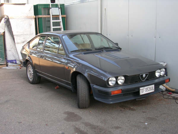

The car in the picture is my car.
The gearbox of this car needs to be rebuilt (new syncros for the 1st and 2nd gear, use the 5th gear syncro on the 3rd and 4th gear, use the 3rd/4th gear synchro on the 5th gear, check the play between forks and sleeves, replace the oil seal rings, check the pinion's head position, the differential bearings preload and the crown/pinion teeth clearance).
I plan to buy a 75 twin spark gearbox, remove the LSD (detaching it from the crown, which will be kept close to the 75 twin spark pinion) and have it installed in lieu of the GTV6 4 satellites open diff. I won't mix crowns and pinions from different gearboxes (I know very well that crown and pinion are matched at the beginning of their lives and can't be mixed. In Italian, they are called "Coppia Conica", because they are a "fixed couple" that can't be divided). However, I plan to use the original GTV6 "Coppia Conica" and the LSD differential.

My plan of action is different and simpler. I have the gtv6 that you can see in the picture. I know that the hypoid gear and the rest is in good shape (no whine, usual synchros problems but these can be fixed duing overhaul). The only new element would be the LSD diff. These diffs can have worn elements, but I have some spare clutches and spacers, so my mechanics is capable to bring it to the original conditions.
