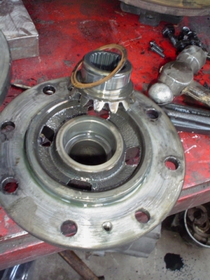

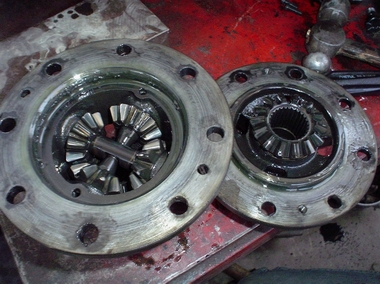

here are some photos of my open differential. Anybody know how I can determine which set of ratios I have? Counting teeth? Serial numbers?

Is there any way that I can figure out what ratios I have now? It is possible thatI have verde ratios already (the car is a verde). It seems that another person (merrill) has found a verde without lsd. I shouldn´t get carried away with paranoia until I actually know somthing about my box. What are the differences between gtv6 and milano boxes? Can I count teeth on any of my gears to determmine my box´s identity?

I had the exact problem. I thought that all Verdes had the LSD and was surprised when mine didn't. I had a similar recent thread and the general recomendation was to go with a transaxle that already has one as there are some very challenging issues regarding alignment of the ring & pinion with a different differential installed. Note that mine had the 3.55 R&P so it likely didn't come from another car and certainly not an 82/83 GTV6.

It's pretty easy to determine the R&P ratio. Just count the teeth on your ring and the teeth on the pinion and devide the pinion number into the ring number.
A way to tell a Milano box from a GTV box is that the later Milano (and 86GTV6 I think) has extra linkages where the shifter rod exits by the clutch. The GTV6 boxes don't have the extra components.

Thanks for the responses. I counted the teeth and it looks like I have the 3.55 final drive. I also checked for the 3.0 stamp and it is there. I am glad to be over the paranoia. 8) For a little while I was afraid that I had a frankenstein car.
